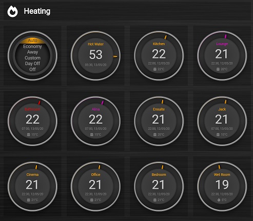

A new beta release of Dashticz, with as new functionality dials for your EvoHome devices, thermostats and dimmers:
To enable the dial representation for your device add the type parameter to the block definition as follows:
blocks['My device'] = {
   idx: 123,
   type: 'dial'
For documentation see:
https://dashticz.readthedocs.io/en/beta ... st-changes
Thanks to clinkadink for the dial functionality. For the dedicated 'Dial' topic see:
https://www.domoticz.com/forum/viewtopi ... 67&t=32749
