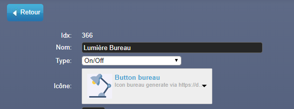

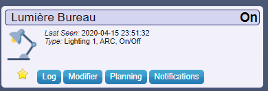

Hello all
I need your help on this case : (may be a bug)
On my switch with type lightning 1, I can change the icone.
bureau Light 1.png (10.84 KiB) Viewed 829 times
bureau Light 2.png (14.07 KiB) Viewed 829 times

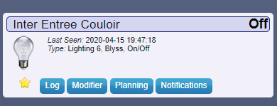

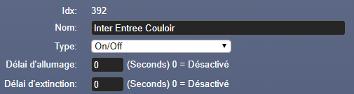

On switches with lignthin 6 : no options....
entree Light 1.png (12 KiB) Viewed 829 times
I couldn't find anytging about that. Is it a bug ?
I'm using 2020.1 on RPI4
Thanks a lot for any ideas.

Re: Can not change icones for switch Lightning 6
xavierlp wrote: Thursday 16 April 2020 10:54 I need your help on this case : (may be a bug)
Can you please try and test by changing line 8 of <domoticz dir>/www/app/devices/deviceFactory.js from
                return ['Light/Switch', 'Lighting 1', 'Lighting 2', 'Lighting 5','Color Switch'].includes(device.Type) &&
to
               return ['Light/Switch', 'Lighting 1', 'Lighting 2', 'Lighting 5','Lighting 6','Color Switch'].includes(device.Type) &&
and clear browser cache and app cache (different things)
Maybe also a domoticz restart is needed.
If successful I will create a PR for this
xavierlp
Posts: 70
Joined: Tuesday 01 November 2016 16:22
Location: France
Post by xavierlp »
Yesssss
It works : Thanks a lot :D
