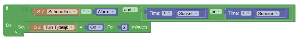

I have a blockly script which turns on a Group of bulbs for 2 minutes, when an Security Door switch "Schuurdeur" is set to "Alarm" and the time is before sunrise or after sunset. But in blockly it is not possible to turn a group on for a certain amount of time. Therefor I have to use a second blockly script where a virtual switch triggers the group on/off. This Virtual Switch "Tuin Tijdelijk" is used in the first blockly script (see picture below) to turn on for 2 minutes.
Is it possible to create this flow in dzVents with a group which is turned on for 2 minutes?
Then I don't need the virtual switch plus the blockly script which triggers the group

gschmidt wrote: Sunday 01 November 2020 12:31 This is the LOG:
Can you show a bit more log? Not only the first couple of seconds but at least 2 cycles of opening and closing the door ?
Maybe this would help you....This is the Script (you have created for me a few months ago) for the "(Virtual Switch) Tuin Verlichting".
You created this for my kitchen light, but I also used it for "Tuin Verlichting".
Sorry but I don't see how this could be connected. The only thing the new script should do is switching a virtual device to On immediate and Off after 11 seconds. But maybe I am overlooking something ?
gschmidt
Posts: 200
Joined: Thursday 20 December 2018 11:03
Re: Turn on a Group for a certain time  [Solved]
Post by gschmidt »
waaren wrote: Sunday 01 November 2020 12:46
Sadly 2 cycles of opening and closing the door have exactly the same LOG messages.
Today I have re-placed in the script: device "Tuin Verlichting" with device "Tuin_Licht_ct".
This (dimmer switch) device is automatically created with the "domoticz-zigbee2mqtt-plugin".
It controls the same zigbee2mqtt group as "Tuin Verlichting" does
And this devices has no problem switching off with afterSec(11)....so strange...
I am using this device now instead of "Tuin Verlichting"
