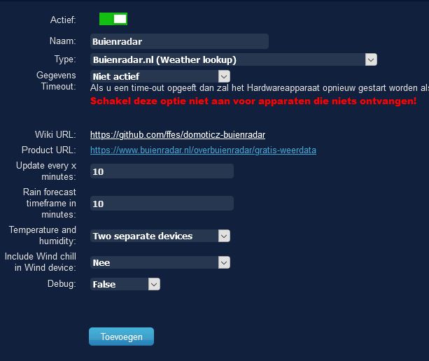

The great thing about the plugin version is you get some options to choose if you want the temperature and humidity sensor separated in two devices or just one.
See the hardware tab here:

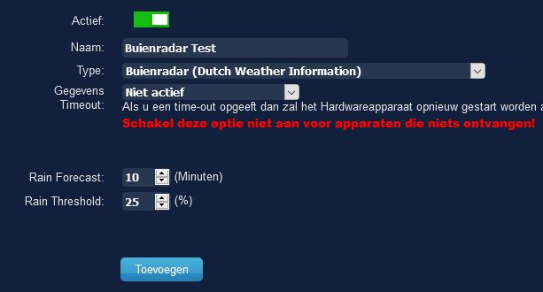

The native plugin has only these options:

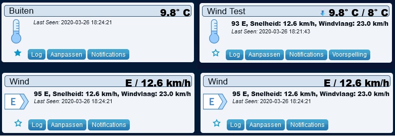

Difference between the sensors:
For the reading in LUA and so on its easier to have separated sensors. I know as you can see in the plugin thread some people like all the information in one and others like me like the separated sensors. So if there would be an option to make the choice your selves we could server everybody.
Hope to hear something.
