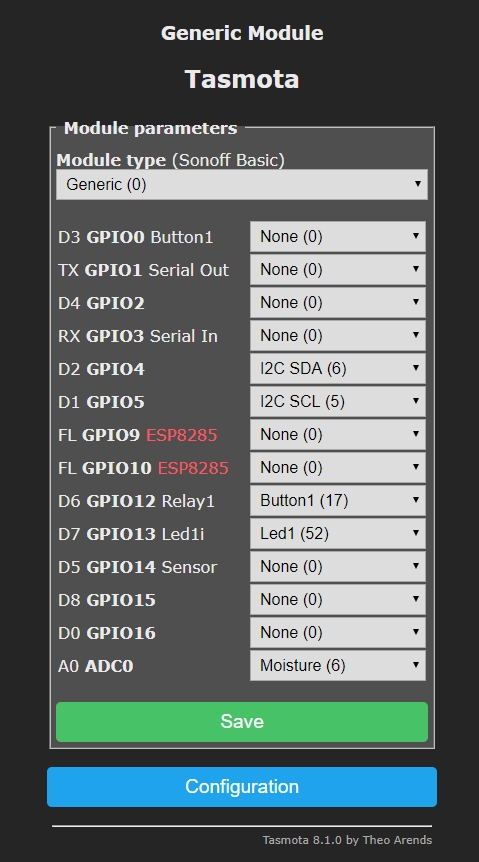

I succesfully installed tasmota on it, and get the soil and temperature :
The thing is I can't get my virtual device updated on domoticz. Nothing's happen. MQQT settings are ok and domoticz's too.

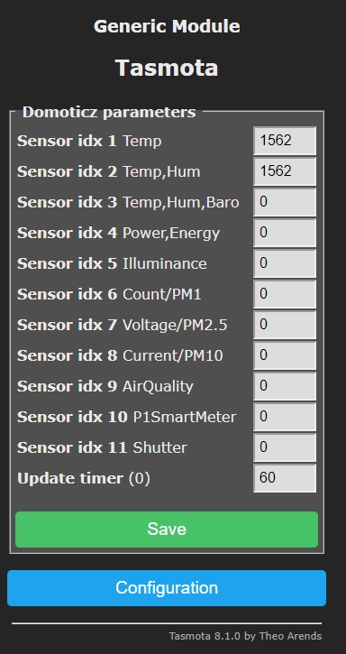

My MQTT settings :
My Domoticz settings :
