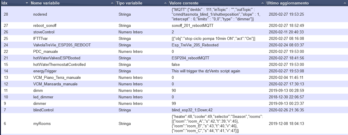

anyway just to havse a first try i cut from the uservar string the inTopic
so used the string that i used is:
{"MQTT":{"devIdx" : 111,"inTopic" : "","outTopic" : "cmnd/tasmota_blind_1/shutterposition","slope" : 1, "intercept" : 0,"limits" : "0,0","type" : "dimmer"}}
Screenshot_2020-02-27 Domoticz.png (35.02 KiB) Viewed 4720 times
idx28 is the numebr of uservar created for nodered
then i try to slide the dummy device type blind inverted, but nothing happened.

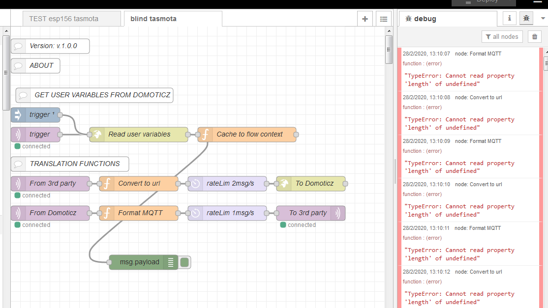

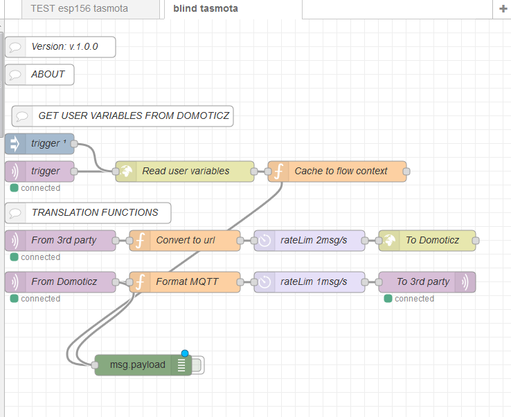

i try to add a debug device to nodered as you can see in the pictures:
Screenshot_2020-02-27 Node-RED 192 168 0 105.png (42.57 KiB) Viewed 4720 times
that's are part of the errors.
27/2/2020, 20:07:12node: Convert to urlfunction : (error)
"TypeError: Cannot read property 'length' of undefined"
27/2/2020, 20:07:13node: Format MQTTfunction : (error)
27/2/2020, 20:07:13node: 834676a2.6a9a88domoticz/out : msg.payload : string[264]
"{↵ "Battery" : 255,↵ "RSSI" : 12,↵ "description" : "",↵ "dtype" : "Light/Switch",↵ "id" : "000140C7",↵ "idx" : 119,↵ "name" : "rele_caldaia_ACS",↵ "nvalue" : 0,↵ "stype" : "Switch",↵ "svalue1" : "0",↵ "switchType" : "On/Off",↵ "unit" : 1↵}↵"
27/2/2020, 20:07:14node: Convert to urlfunction : (error)
27/2/2020, 20:07:15node: Format MQTTfunction : (error)
27/2/2020, 20:07:16node: 834676a2.6a9a88domoticz/out : msg.payload : string[310]
"{↵ "Battery" : 255,↵ "RSSI" : 9,↵ "description" : "",↵ "dtype" : "Temp + Humidity",↵ "id" : "82153",↵ "idx" : 153,↵ "name" : "Cucina cantina",↵ "nvalue" : 0,↵ "stype" : "THGN122/123/132, THGR122/228/238/268",↵ "svalue1" : "16.50",↵ "svalue2" : "46.8",↵ "svalue3" : "1",↵ "unit" : 1↵}↵"
27/2/2020, 20:07:17node: Convert to urlfunction : (error)
27/2/2020, 20:07:18node: Format MQTTfunction : (error)

anyway i also tested your proposal of domoticz uservar:
but if i slide the domoticz slider of dummy device set as inverted blind with percentage nothing happened.
iside nodered i create a debug switch and connect to uservar from domoticz
Screenshot_2020-02-28 Node-RED 192 168 0 105.png (63.04 KiB) Viewed 4692 times
this is the log:
it seams that it not read the uservar, possible??
28/2/2020, 13:05:53node: Convert to urlfunction : (error)
28/2/2020, 13:05:53node: Format MQTTfunction : (error)
28/2/2020, 13:05:55node: Convert to urlfunction : (error)
28/2/2020, 13:05:56node: Format MQTTfunction : (error)
28/2/2020, 13:05:57node: Convert to urlfunction : (error)
28/2/2020, 13:05:58node: Format MQTTfunction : (error)
28/2/2020, 13:05:59node: Convert to urlfunction : (error)
28/2/2020, 13:06:00node: Format MQTTfunction : (error)
28/2/2020, 13:06:00node: Convert to urlfunction : (error)
28/2/2020, 13:06:02node: Convert to urlfunction : (error)
28/2/2020, 13:06:02node: Format MQTTfunction : (error)
28/2/2020, 13:06:03node: Convert to urlfunction : (error)
28/2/2020, 13:06:03node: Format MQTTfunction : (error)
28/2/2020, 13:06:04node: Convert to urlfunction : (error)
28/2/2020, 13:06:04node: Format MQTTfunction : (error)
28/2/2020, 13:06:07node: Convert to urlfunction : (error)
28/2/2020, 13:06:07node: Format MQTTfunction : (error)

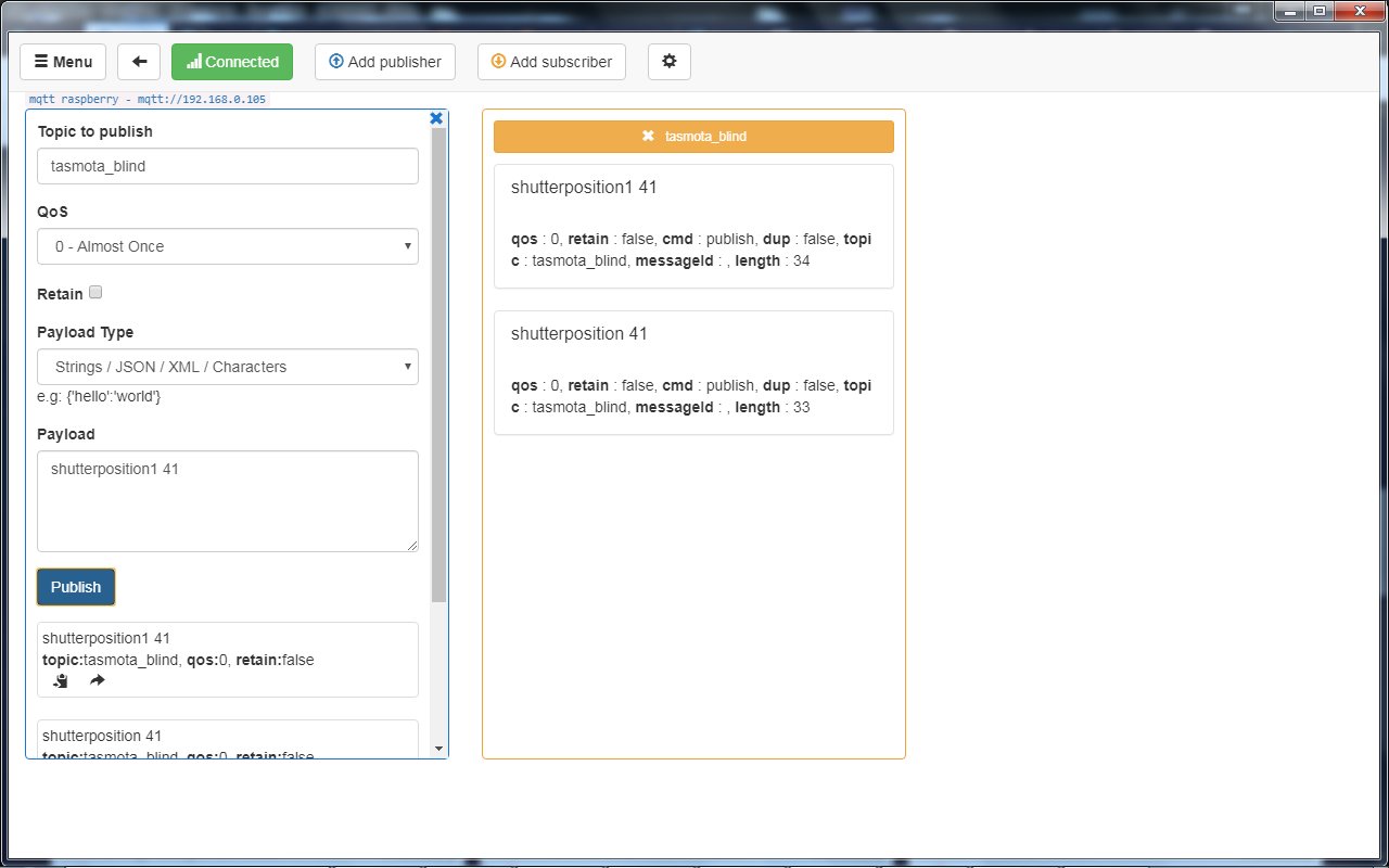

thanks i find and extension of google chrome: mqttLens
i configure the IP of broker and make a connection.
now it ask me subscrive topic or publish topic.
what i have to enter?
thanks

megamarco83 wrote: Friday 28 February 2020 14:49 thanks i find and extension of google chrome: mqttLens
thanks
subscribe to tasmota_blind

Try this flow:
[{"id":"17010ea5.44ab11","type":"tab","label":"mqtt traductor salva","disabled":false,"info":""},{"id":"2f099dcf.665432","type":"comment","z":"17010ea5.44ab11","name":"Version: v.1.0.0","info":"","x":200,"y":140,"wires":[]},{"id":"e3fd556.de12ba8","type":"comment","z":"17010ea5.44ab11","name":"ABOUT","info":"This software originate from https://github.com/kungknut/Domoticz-MQTT-Translator\n\nIf you find a bug or want to contribute to make this software better? Feel \nfree to open an issue or a pull request.","x":170,"y":180,"wires":[]},{"id":"de6a25fe.da91c8","type":"mqtt out","z":"17010ea5.44ab11","name":"To 3rd party","topic":"","qos":"","retain":"","broker":"8bc033be.f9277","x":730,"y":480,"wires":[]},{"id":"4f21a53f.99596c","type":"mqtt in","z":"17010ea5.44ab11","name":"From 3rd party","topic":"#","qos":"0","broker":"8bc033be.f9277","x":200,"y":420,"wires":[["813bffcb.6c1a1"]]},{"id":"cc5613c.108d2f","type":"http request","z":"17010ea5.44ab11","name":"To Domoticz","method":"GET","ret":"txt","url":"","tls":"","x":730,"y":420,"wires":[[]]},{"id":"5e1ae03c.9df0b","type":"mqtt in","z":"17010ea5.44ab11","name":"From Domoticz","topic":"domoticz/out","qos":"0","broker":"8bc033be.f9277","x":200,"y":480,"wires":[["3a5786d1.d605ca"]]},{"id":"3a5786d1.d605ca","type":"function","z":"17010ea5.44ab11","name":"Format MQTT","func":"var domoticzServer = \"http://localhost\";\nvar userVarValues = flow.get(\"userVarValues\");\n\n// Find what row in the userVarValues array that hold the settings for the reporting device\nvar mqttPayload = JSON.parse(msg.payload);\nvar arrI = null;\nfor (var i = 0; i < userVarValues.length; i++){\n    if(mqttPayload.idx == userVarValues[i].devIdx){\n        arrI = i;\n    }\n}\n\n// If no match is found, exit this function and return null\nif(arrI !== null){\n    // Find out which type of device that submitted the value\n    var userVar = userVarValues[arrI];\n    if(typeof userVar.slope === 'undefined') userVar.slope = 1;\n    if(typeof userVar.intercept === 'undefined') userVar.intercept = 0;\n    if(userVar.type != \"switch\") var aval = (mqttPayload.svalue1 - userVar.intercept) / userVar.slope;\n    \n    switch(userVar.type) {\n        case \"dimmer\":\n            // DIMMER 0-100%\n            msg.topic = userVar.outTopic;\n            msg.payload = aval;\n            switch(mqttPayload.nvalue) {\n                case 0:\n                    msg.payload = 0;\n                    break;\n                case 1:\n                    msg.payload = context.get(userVar.outTopic)||50;\n                    break;\n                case 2:\n                    context.set(userVar.outTopic, aval);\n                    break;\n            }\n            break;\n        case \"switch\":\n            // SWITCH ON/OFF\n            // OBS - Domoticz is case sensitive\n            msg.topic = userVar.outTopic;\n            if(mqttPayload.nvalue == \"1\"){\n                msg.payload = \"ON\";\n            } else if (mqttPayload.nvalue == \"0\"){\n                msg.payload = \"OFF\";\n            }\n            break;\n        case \"shutter\":\n            // SHUTTER 0-100%\n            msg.topic = userVar.outTopic;\n            msg.payload = aval;\n            switch(mqttPayload.nvalue) {\n                case 0:\n                    msg.payload = 0;\n                    break;\n                case 1:\n                    msg.payload = 100;\n                    break;\n                case 2:\n                    context.set(userVar.outTopic, aval);\n                    break;\n                    }\n            break;\n        case \"svalue1\":\n            // Thermostat setpoint\n            msg.topic = userVar.outTopic;\n            msg.payload = aval;\n            break;\n        default:\n            msg.topic = null;\n    }\n}else {\n    msg.topic = null;\n}\n\nif(msg.topic !== null){\n    return msg;\n}","outputs":1,"noerr":0,"x":380,"y":480,"wires":[["cf7bf70d.710d38"]]},{"id":"813bffcb.6c1a1","type":"function","z":"17010ea5.44ab11","name":"Convert to url","func":"var domoticzServer = \"http://localhost:8080\";\nvar userVarValues = flow.get(\"userVarValues\");\n\n// Find what row in the userVarValues array that hold the settings for the reporting device\nvar arrI = null;\nfor (var i = 0; i < userVarValues.length; i++){\n    if(msg.topic == userVarValues[i].inTopic){\n        arrI = i;\n    }\n}\n\n// If no match is found, exit this function and return null\nif(arrI !== null){\n    // Find out which type of device that submitted the value\n    var userVar = userVarValues[arrI];\n    if(typeof userVar.limits === 'undefined') userVar.limits = \"0,0\";\n    if(typeof userVar.slope === 'undefined') userVar.slope = 1;\n    if(typeof userVar.intercept === 'undefined') userVar.intercept = 0;\n    if(userVar.type != \"switch\") var aval = (msg.payload * userVar.slope) + userVar.intercept;\n    \n    switch(userVar.type) {\n        case \"svalue\":  // Temperature, Percent, Pressure, Voltage, Text, Distance\n        case \"svalue1\": // Thermostat setpoint\n            msg.url = domoticzServer + \"/json.htm?type=command&param=udevice&idx=\" + userVar.devIdx + \"&nvalue=0&svalue=\" + aval;\n            break;\n        case \"shutter_old\": // Thermostat setpoint\n            msg.url = domoticzServer + \"/json.htm?type=command&param=udevice&idx=\" + userVar.devIdx + \"&nvalue=2&svalue=\" + aval;\n            break;\n        case \"humidity\":\n            // Humidity level\n            var humStat = 0; // 0 = Normal, 1 = Comfortable, 2 = Dry, 3 = Wet\n            var lims = userVar.limits.split(\";\");\n            var limits = [];\n            for (var i = 0; i < lims.length; i++){\n                var obj = lims[i].split(\",\");\n                if(aval >= obj[1]) humStat = obj[0];\n            }\n            msg.url = domoticzServer + \"/json.htm?type=command&param=udevice&idx=\" + userVar.devIdx + \"&nvalue=\" + aval + \"&svalue=\" + humStat;\n            break;\n        case \"switch\":\n            // Binary switch (ON/OFF)\n            // Domoticz is case sensitive\n            if(msg.payload == \"ON\" || msg.payload == \"OFF\"){\n                msg.payload = msg.payload.toLowerCase();\n                msg.payload = msg.payload.charAt(0).toUpperCase() + msg.payload.slice(1);\n                msg.url = domoticzServer + \"/json.htm?type=command&param=switchlight&idx=\" + userVar.devIdx + \"&switchcmd=\" + msg.payload;\n            }\n            break;\n        case \"dimmer\":\n            // Dimmer 0-100%\n            var level = parseInt(aval) + 1; // Bug in Domoticz require the \"in\" message to be 1 higher than actual value.\n            msg.url = domoticzServer + \"/json.htm?type=command&param=switchlight&idx=\" + userVar.devIdx + \"&switchcmd=Set%20Level&level=\" + level;\n            if(msg.payload == \"0\"){\n                msg.url = domoticzServer + \"/json.htm?type=command&param=switchlight&idx=\" + userVar.devIdx + \"&switchcmd=Off\";\n            }\n            break;\n        case \"shutter\":\n            // Shutter 0-100%\n            var level = parseInt(aval); // Bug in Domoticz require the \"in\" message to be 1 higher than actual value.\n            msg.url = domoticzServer + \"/json.htm?type=command&param=switchlight&idx=\" + userVar.devIdx + \"&switchcmd=Set%20Level&level=\" + level;\n            if(msg.payload == \"0\"){\n                msg.url = domoticzServer + \"/json.htm?type=command&param=switchlight&idx=\" + userVar.devIdx + \"&switchcmd=Off\";\n            }\n            break;\n        default:\n            msg.url = null;\n            break;\n    }\n} else {\n    msg.url = null;\n}\n\nif(msg.url !== null){\n    return msg;\n}","outputs":1,"noerr":0,"x":380,"y":420,"wires":[["f1960ba6.853bb8"]]},{"id":"65eafdbd.a7c764","type":"comment","z":"17010ea5.44ab11","name":"GET USER VARIABLES FROM DOMOTICZ","info":"","x":290,"y":240,"wires":[]},{"id":"e412dc01.a3452","type":"comment","z":"17010ea5.44ab11","name":"TRANSLATION FUNCTIONS","info":"","x":240,"y":380,"wires":[]},{"id":"5167d1a1.edf9e","type":"http request","z":"17010ea5.44ab11","name":"Read user variables","method":"GET","ret":"txt","url":"http://localhost:8080/json.htm?type=command&param=getuservariables","tls":"","x":380,"y":320,"wires":[["537a1ec2.9b5ba"]]},{"id":"537a1ec2.9b5ba","type":"function","z":"17010ea5.44ab11","name":"Cache to flow context","func":"msg.payload = JSON.parse(msg.payload);\nvar userVarRes = msg.payload.result,\n    userVarValues = [],\n    hueStats = {};\n\n\nfor (var i = 0; i < userVarRes.length; i++){\n    var obj = userVarRes[i];\n    for (var key in obj){\n        if(key == \"Value\"){\n            var val = JSON.parse(obj[key]);\n            if(val.MQTT !== undefined) {\n                userVarValues.push(val.MQTT);\n            }\n        }\n    }\n}\n\nflow.set(\"userVarValues\", userVarValues);\n\n//msg.payload = flow.get(\"userVarValues\");\n//return msg;","outputs":1,"noerr":0,"x":600,"y":320,"wires":[[]]},{"id":"9ae0eedd.09a41","type":"mqtt in","z":"17010ea5.44ab11","name":"trigger","topic":"nodered/update-uservar","qos":"2","broker":"8bc033be.f9277","x":170,"y":320,"wires":[["5167d1a1.edf9e"]]},{"id":"b84d9ce3.f5c28","type":"inject","z":"17010ea5.44ab11","name":"trigger","topic":"","payload":"","payloadType":"date","repeat":"","crontab":"","once":true,"x":170,"y":280,"wires":[["5167d1a1.edf9e"]]},{"id":"f1960ba6.853bb8","type":"delay","z":"17010ea5.44ab11","name":"rateLim 2msg/s","pauseType":"rate","timeout":"5","timeoutUnits":"seconds","rate":"2","nbRateUnits":"1","rateUnits":"second","randomFirst":"1","randomLast":"5","randomUnits":"seconds","drop":false,"x":560,"y":420,"wires":[["cc5613c.108d2f"]]},{"id":"cf7bf70d.710d38","type":"delay","z":"17010ea5.44ab11","name":"rateLim 1msg/s","pauseType":"rate","timeout":"5","timeoutUnits":"seconds","rate":"1","nbRateUnits":"1","rateUnits":"second","randomFirst":"1","randomLast":"5","randomUnits":"seconds","drop":false,"x":560,"y":480,"wires":[["de6a25fe.da91c8"]]},{"id":"8bc033be.f9277","type":"mqtt-broker","z":"17010ea5.44ab11","broker":"localhost","port":"1883","clientid":"MQTTTRANSLATORNODEREDMQTTCLIENT","usetls":false,"compatmode":true,"keepalive":"60","cleansession":true,"birthTopic":"","birthQos":"0","birthPayload":"","willTopic":"","willQos":"0","willPayload":""}]
Change your user variable type to "shutter"

salvacalatayud wrote: Friday 28 February 2020 18:07 Change your user variable type to "shutter"
hi, i imported your flow, but didn't working.
i also subscribe to topic:
tasmota_blind
but if i move slide inside domoticz i didn't see nothing.

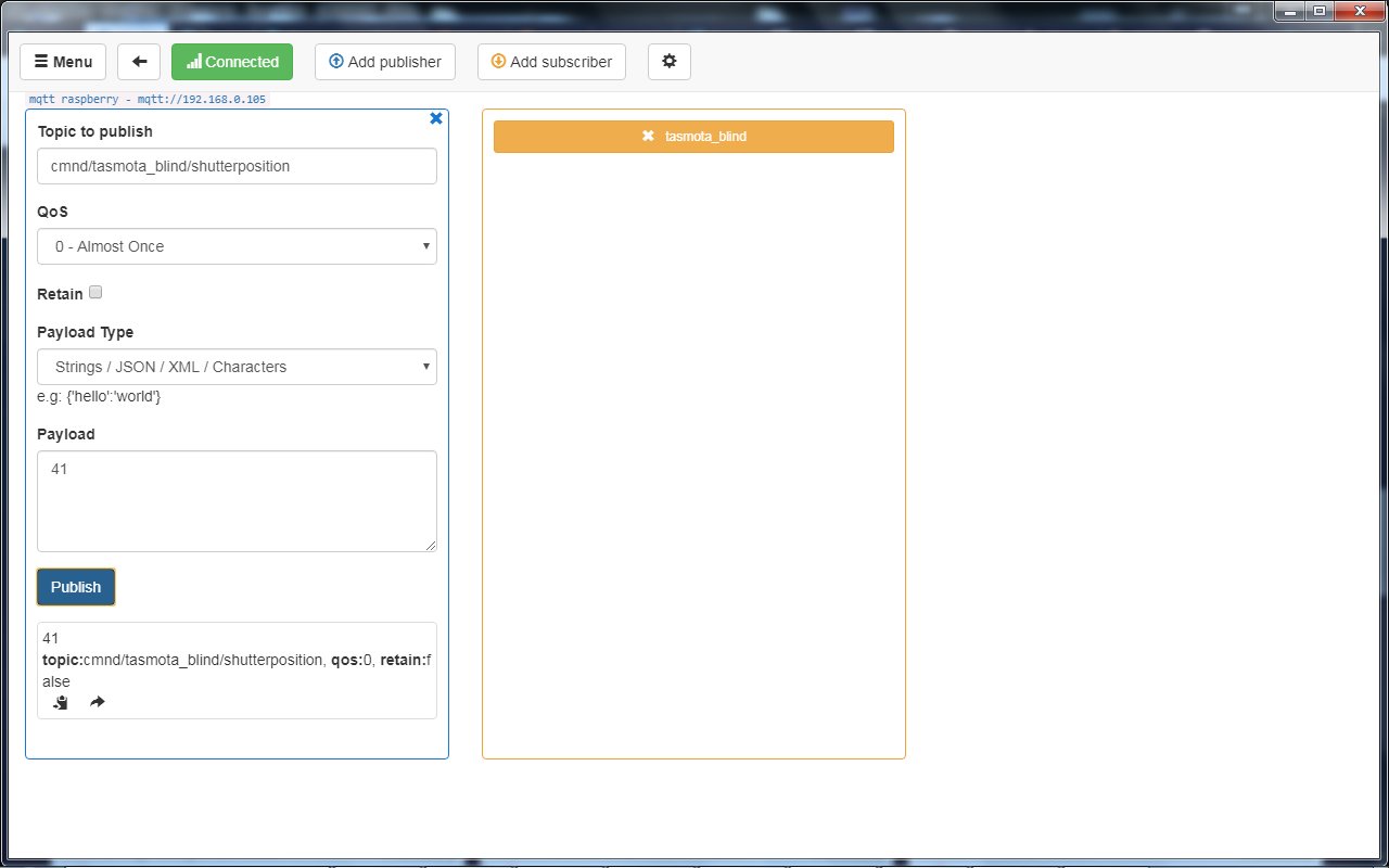

this is my uservar:
{"MQTT":{"devIdx" : 111,"inTopic" : "cmnd/tasmota_blind/shutterposition1","outTopic" : "stat/tasmota_blind/SHUTTER1","slope" : 1, "intercept" : 0,"limits" : "0,0","type" : "shutter"}
i also try to publish command like in the uservar:
topic = cmnd/tasmota_blind/shutterposition1
payload = 41
in this case the relay is triggered but can't see nothing:
i try to change the topic
topic = tasmota_blind
payload = shutterposition1 41
and now i'm able to see the subscriber but in this case the relay is not trigered

it continue to increase, maybe is here the problem?
that's my "read user variable" inside node red:
http://192.168.0.105:8085/json.htm?type=command&param=getuservariables
and this is the json if i put that string inside web brawser:
   "result" : [
         "LastUpdate" : "2019-12-19 08:45:12",
         "Name" : "Calorifero_Bagno_PT_manuale",
         "Type" : "0",
         "Value" : "0",
         "idx" : "3"
         "LastUpdate" : "2020-01-18 19:24:35",
         "Name" : "Calorifero_Bagno_Mansarda_manuale",
         "Type" : "0",
         "Value" : "0",
         "idx" : "4"
         "LastUpdate" : "2019-12-08 18:04:13",
         "Name" : "myRooms",
         "Type" : "2",
         "Value" : "{\"heater\":48,\"cooler\":49,\"selector\":\"Season\",\"rooms\":[{\"room\":\"room_A\",\"s\":42,\"t\":39,\"v\":45},{\"room\":\"room_B\",\"s\":43,\"t\":40,\"v\":46},{\"room\":\"room_C\",\"s\":44,\"t\":41,\"v\":47}]}",
         "idx" : "6"
         "LastUpdate" : "2020-02-26 21:36:35",
         "Name" : "blindControl",
         "Type" : "2",
         "Value" : "blind_esp32_1;Down;42",
         "idx" : "7"
         "LastUpdate" : "2019-09-13 00:23:37",
         "Name" : "dimmer",
         "Type" : "0",
         "Value" : "99",
         "idx" : "9"
         "LastUpdate" : "2018-12-30 22:06:57",
         "Name" : "led_dimmer",
         "Type" : "0",
         "Value" : "0",
         "idx" : "10"
         "LastUpdate" : "2019-09-13 00:28:59",
         "Name" : "dimm",
         "Type" : "0",
         "Value" : "90",
         "idx" : "11"
         "LastUpdate" : "2020-02-29 17:30:11",
         "Name" : "VCM_Mansarda_manuale",
         "Type" : "0",
         "Value" : "0",
         "idx" : "12"
         "LastUpdate" : "2020-02-04 11:45:11",
         "Name" : "VCM_Piano_Terra_manuale",
         "Type" : "0",
         "Value" : "0",
         "idx" : "13"
         "LastUpdate" : "2020-02-29 17:47:35",
         "Name" : "energyTrigger",
         "Type" : "2",
         "Value" : "This will trigger the dzVents script again",
         "idx" : "14"
         "Name" : "hotWaterThermostatControlled",
         "Type" : "2",
         "Value" : "false",
         "idx" : "15"
         "LastUpdate" : "2020-02-29 17:37:29",
         "Name" : "hotWaterValvesESPBooted",
         "Type" : "2",
         "Value" : "ESP204_rebootMQTT",
         "idx" : "21"
         "Name" : "PDC_manuale",
         "Type" : "0",
         "Value" : "0",
         "idx" : "22"
         "LastUpdate" : "2020-02-28 01:00:46",
         "Name" : "ValvolaTreVie_ESP205_REBOOT",
         "Type" : "2",
         "Value" : "Esp_TreVie_205_Rebooted",
         "idx" : "24"
         "LastUpdate" : "2020-02-27 20:21:51",
         "Name" : "IFTTTvar",
         "Type" : "2",
         "Value" : "[{\"obj\":\"piantana camera\",\"act\":\"On\"}]",
         "idx" : "25"
         "LastUpdate" : "2020-02-11 20:40:33",
         "Name" : "stoveControl",
         "Type" : "0",
         "Value" : "2",
         "idx" : "26"
         "LastUpdate" : "2020-02-29 17:18:45",
         "Name" : "reboot_sonoff",
         "Type" : "2",
         "Value" : "sonoff_200_rebootMQTT",
         "idx" : "27"
         "LastUpdate" : "2020-02-29 17:38:49",
         "Name" : "nodered",
         "Type" : "2",
         "Value" : "{\"MQTT\":{\"devIdx\" : 111,\"inTopic\" : \"stat/tasmota_blind/shutterposition\",\"outTopic\" : \"stat/tasmota_blind/shutterposition1\",\"slope\" : 1, \"intercept\" : 0,\"limits\" : \"0,0\",\"type\" : \"shutter\"}",
         "idx" : "28"
   "status" : "OK",
   "title" : "GetUserVariables"
using the MQTTlens i see that if i use:
1) as topic to publish = cmnd/tasmota_blind/shutterposition
payload = 33 (for example to put blind at 33%)
2) i'm subscrive to:
i receive: 33
i'm subscrive to:
stat/tasmota_blind/RESULT
i receive:
{"Shutter1":{"Position":33,"Direction":0},"Shutter2":{"Position":40,"Direction":0}}
{"POWER2":"OFF"}
{"Shutter1":{"Position":52,"Direction":-1},"Shutter2":{"Position":40,"Direction":0}}
{"ShutterPosition1":33}
{"POWER2":"ON"}
