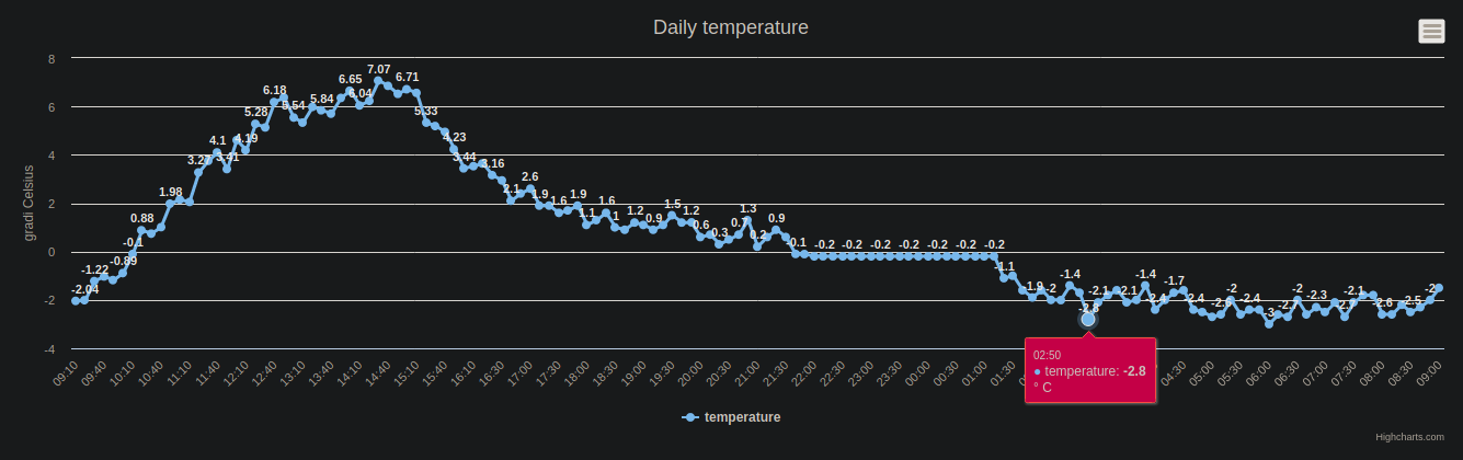

following some posts and your indications, I was able in part to create a chart (similar to that of domoticz made with highcharts) online.
I did so
  • inserted in domoticz the script dzvents written by @waaren
        script to create a CSV file with following layout.
        now,inside,target,outside,lounge,greenhouse,heating  [header row]
        22:10,21.2,7.0,12.7,21.3,11.8,0   [oldest data: 24 hours minus 10 mins. ago]
        22:20,21.1,7.0,12.7,21.3,11.8,0   [next data: 10 mins. later]
        22:00,21.1,7.0,9.4,22.0,8.0,0     [latest data]
            History:
            20200108: Start coding
            20200110: Start testing on life situation (thanks to MikeF)
            20200122: First public release
    return

  • exported to the site with cron ----> sftp the daily file temperature.csv
  • created using the free online editor http://editor.highcharts.com/full.html exported to the site and I get this chart.
    Schermata del 2020-12-14 09.08.00.png (63.55 KiB) Viewed 1774 times
  • Emulating the daily chart of domoticz I have these problems :
    • in the tooltips and in the title of the graph, how to insert the date
    • in case of sensor lock, the last temperature is shown several times in the graph until the sensor is unlocked (how to insert an interruption)
    • how to insert the zoom of a part of the graph
    • on the horizontal axis how to insert only the hourly values and at midnight the day.
    • you could also insert the barometer values in a single graph and 2 splines
