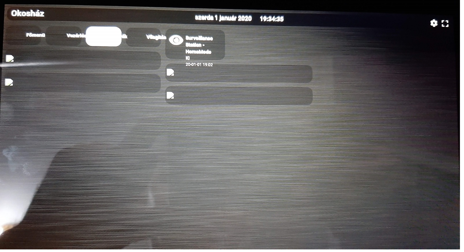

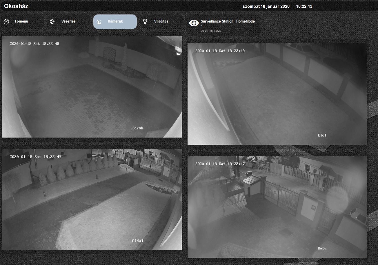

Help me. My hikvision cameras works fine on my computer, but don't work on android tablet. I tried wallPanel, fully kiosk, chrome ect. but nothing.
config.js
buttons.webcam_sarok = {forcerefresh:true, width:12, isimage:true, refreshimage: 2000, refreshurl: 2000, refresh:1000, image: 'http://xxxx:[email protected]/ISAPI/ ... 02/picture'}
Dachticz and hikvision cameras

- tablet
- tablet.jpg (369.36 KiB) Viewed 942 times
- computer
- computer.jpg (344.45 KiB) Viewed 942 times
