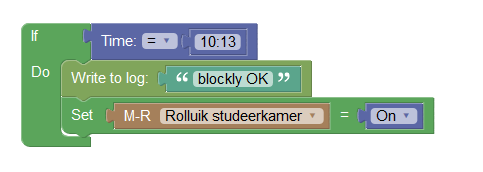

If I run a Blockly script the blinds do react:
2019-12-24 10:13:00.159 EventSystem: Event triggered: Test Blockly_1
2019-12-24 10:13:00.171 (RFXtrx433) RFY (Unknown)
2019-12-24 10:13:00.119 Status: dzVents: Debug: Dumping domoticz data to /home/pi/domoticz/scripts/dzVents/domoticzData.lua
2019-12-24 10:13:00.131 Status: dzVents: Debug: Event triggers:
2019-12-24 10:13:00.131 Status: dzVents: Debug: - Timer
2019-12-24 10:13:00.159 Status: blockly OK
Although the command On sends it down and the command Open sends it to the stop-position.
So why the dsVents script doesn't work?

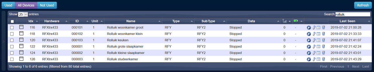

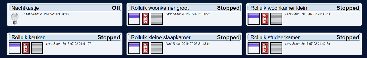

I never looked at the the last seen date, but all blinds have the same date. (The temparature senser has a last seen date of today, so I'm getting data back from the serial port.)
Why can I use Domoticz to control the blinds if the devices are unknown?

waaren wrote: Tuesday 24 December 2019 19:56 One reason could be that is not set to active in the devices tab, dzVents will not react in such a case but it stil can be operated from the devices tab.
These are all my blinds:
What do you mean by active?
Because they are used but I see no active setting.

Hesitated wrote: Tuesday 24 December 2019 21:17 What do you mean by active?
Just what you showed in the device tab. If the white arrow is in blue background cirkel it is active for domoticz. (if it's on a green one it is not)

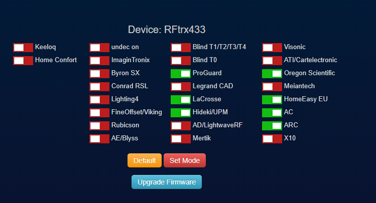

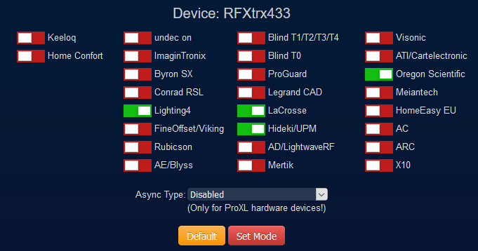

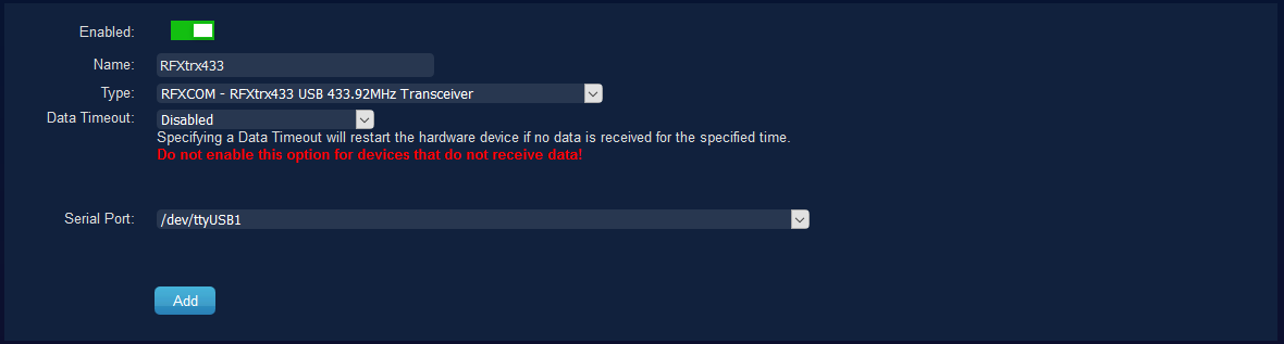

My setting of the RFXComm device:
The mode settings of the RFXComm device:
Domoticz 2020.2 - RPi3B+ - RFXtrx433XL - P1 - CC2531 - Somfy - Xiaomi - Hue - Omron - MQTT

my settings of the RFtrx433
Settings of RFtrx433

Change of settings of the RFtrx433 doesn't change anything, so that is not the problem here.

This dump is completely different from the one I posted earlier.
It appears that when the event is triggered based on time the correct item is found in the dump, but sending a command still fails.
But if it is triggered by clicking a switch even the dump fails... :?: :?: :?:
Based on a time trigger the log contains these lines:

2019-12-26 20:25:00.229 Status: dzVents: > switchOff()
2019-12-26 20:25:00.229 Status: dzVents: > startPlaylist()
2019-12-26 20:25:00.229 Status: dzVents: > deviceType: RFY
2019-12-26 20:25:00.229 Status: dzVents: > isHTTPResponse: false
2019-12-26 20:25:00.229 Status: dzVents: > state: Stop
2019-12-26 20:25:00.229 Status: dzVents: > unit: 1
2019-12-26 20:25:00.229 Status: dzVents: > _adapters:
2019-12-26 20:25:00.229 Status: dzVents: > 1: Switch device adapter
2019-12-26 20:25:00.229 Status: dzVents: > changed: false
2019-12-26 20:25:00.229 Status: dzVents: > deviceId: 000003
2019-12-26 20:25:00.229 Status: dzVents: > pause()
2019-12-26 20:25:00.229 Status: dzVents: > _data:
2019-12-26 20:25:00.229 Status: dzVents: > timedOut: true
2019-12-26 20:25:00.229 Status: dzVents: > data:
2019-12-26 20:25:00.229 Status: dzVents: > levelVal: 0
2019-12-26 20:25:00.229 Status: dzVents: > hardwareID: 8
2019-12-26 20:25:00.229 Status: dzVents: > protected: false
2019-12-26 20:25:00.229 Status: dzVents: > hardwareTypeValue: 1
2019-12-26 20:25:00.229 Status: dzVents: > hardwareName: RFXtrx433
2019-12-26 20:25:00.230 Status: dzVents: > maxDimLevel: 0
2019-12-26 20:25:00.230 Status: dzVents: > icon: blinds
2019-12-26 20:25:00.230 Status: dzVents: > usedByCamera: false
2019-12-26 20:25:00.230 Status: dzVents: > hardwareType: RFXCOM - RFXtrx433 USB 433.92MHz Transceiver
2019-12-26 20:25:00.230 Status: dzVents: > _nValue: 0
2019-12-26 20:25:00.230 Status: dzVents: > _state: Stop
2019-12-26 20:25:00.230 Status: dzVents: > signalLevel: 0
2019-12-26 20:25:00.230 Status: dzVents: > deviceType: RFY
2019-12-26 20:25:00.230 Status: dzVents: > name: Rolluik studeerkamer
2019-12-26 20:25:00.230 Status: dzVents: > changed: false
2019-12-26 20:25:00.230 Status: dzVents: > switchTypeValue: 15
2019-12-26 20:25:00.230 Status: dzVents: > deviceID: 000003
2019-12-26 20:25:00.230 Status: dzVents: > id: 126
2019-12-26 20:25:00.230 Status: dzVents: > lastUpdate: 2019-07-02 21:43:29
2019-12-26 20:25:00.230 Status: dzVents: > lastLevel: 0
2019-12-26 20:25:00.230 Status: dzVents: > batteryLevel: 255
2019-12-26 20:25:00.230 Status: dzVents: > switchType: Venetian Blinds EU
2019-12-26 20:25:00.230 Status: dzVents: > subType: RFY2
2019-12-26 20:25:00.230 Status: dzVents: > description:
2019-12-26 20:25:00.230 Status: dzVents: > rawData:
2019-12-26 20:25:00.230 Status: dzVents: > baseType: device
2019-12-26 20:25:00.230 Status: dzVents: > updateSetPoint()
2019-12-26 20:25:00.230 Status: dzVents: > setHex()
2019-12-26 20:25:00.230 Status: dzVents: > protected: false
2019-12-26 20:25:00.230 Status: dzVents: > updateRain()
2019-12-26 20:25:00.230 Status: dzVents: > increaseBrightness()
2019-12-26 20:25:00.230 Status: dzVents: > setVolume()
2019-12-26 20:25:00.230 Status: dzVents: > hardwareName: RFXtrx433
2019-12-26 20:25:00.230 Status: dzVents: > active: false
2019-12-26 20:25:00.230 Status: dzVents: > isScene: false
2019-12-26 20:25:00.230 Status: dzVents: > setState()
2019-12-26 20:25:00.231 Status: dzVents: > description:
2019-12-26 20:25:00.231 Status: dzVents: > rawData:
2019-12-26 20:25:00.231 Status: dzVents: > _state: Stop
2019-12-26 20:25:00.231 Status: dzVents: Debug: Constructed timed-command: On
2019-12-26 20:25:00.231 Status: dzVents: Info: ------ Finished Dump script
2019-12-26 20:25:00.232 Status: EventSystem: Script event triggered: /home/pi/domoticz/dzVents/runtime/dzVents.lua
2019-12-26 20:25:00.264 Error: Switch command not send!, Hardware device disabled or not found!
