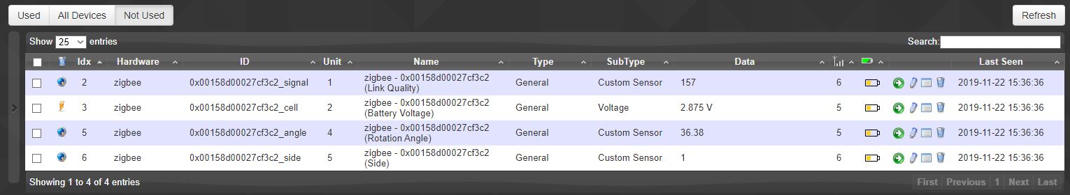

I just setup zigbee2mqtt and it seems to work fine.
The only device that I cannot get to work is the xiaomi cube. It adds a couple of devices but I am not really sure what to do with them.
Is there a tutorial for setting up the cube in domoticz?
I added a shot of the created devices to my post.
Aqara/ Xiaomi Cube turotial
- 1.JPG (76.1 KiB) Viewed 904 times

Re: Aqara/ Xiaomi Cube turotial
Hi nephulim,
Just was wondering about that one.
In above picture you can push the green arrows to add the device you want i added the device that gives the switch not using batteries for now.
then i renamed my cube to CUBE1
then i added an ikea light and some other devices, but below the device to control is : zig-stalamp- ikea-e27
then i went to configuration settings and clicked on events, then i create a lua event.. with below. (devicetype)
HOpe this helps, cheers.
