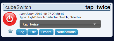

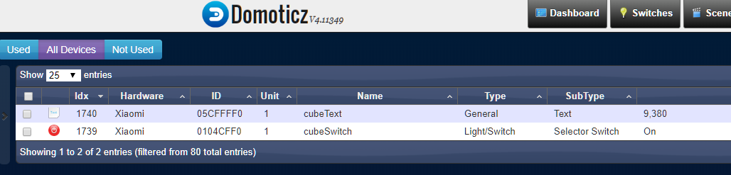

I use something similar
return
 on =
    devices =
        'cubeSwitch'
    execute = function(dz,item)
        local cubeState = item.levelName
        dz.log('cube state: ' .. cubeState,dz.LOG_FORCE)
        os.execute ('/bashdir/argtest.sh ' .. cubeState)
Log
2019-10-07 22:57:03.093 Status: dzVents: Info: ------ Start external script: Xcube.lua: Device: "cubeSwitch (Xiaomi)", Index: 1739
2019-10-07 22:57:03.093 Status: dzVents: !Info: cube state: clock_wise
2019-10-07 22:57:03.108 Status: dzVents: Info: ------ Finished Xcube.lua
