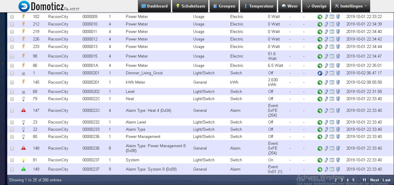

Re: ID of zwave devices
Post by ropske »
I'm running now V4.10717 and default theme, but it is not in anymore it seems
jvdz
Posts: 2445
Domoticz version: 4.107
Post by jvdz »
I am sorry to see this rather simply patch I made has met so much objection. There are several threads in this forum about it and a couple in Github, where you can see how many have argued for having this patch in but it aint happening. You probably seen I sort-of gave up arguing. :(

jvdz
Posts: 2445
Post by jvdz »
This is the original thread where the proposal was posted and further discussed: https://www.domoticz.com/forum/viewtopi ... 36#p163786 and resulted in this initial pull request with these code changes: https://github.com/domoticz/domoticz/pull/2033/files
This patch will show the ZWAVEID in HEX behind the DeviceID.
It was then changed to Highlight by this patch: https://github.com/domoticz/domoticz/pull/2664/files.
I haven't installed the 4.**** version as yet as my current setup is rocksolid. My test system is running 4.10262, but it seems changes were made after that version to the filestructure as the file /www/app/DevicesController.js doesn't exist anymore in the latest Beta.
A quick search found that in file www/app/Devices.js line 255 contains the part that was modified originally in the second patch:
				var ID = device.ID;
				if (typeof(device.HardwareTypeVal) != 'undefined' && device.HardwareTypeVal == 21) {
					if (device.ID.substr(-4, 2) == '00') {
						ID = device.ID.substr(1,device.ID.length-2) + '<span class="ui-state-default">' + device.ID.substr(-2, 2) + '</span>';
					} else {
						ID = device.ID.substr(1,device.ID.length-4) + '<span class="ui-state-default">' + device.ID.substr(-4, 2) + '</span>' + device.ID.substr(-2, 2);
So I have no idea why it doesn't highlight for you, but you could try to check in Chrome with the developer mode (F12) and check out the generated source for the page/device to see if it is there. Also check if the class "ui-state-default" is still valid and different from the rest of the formatting.
Jos
