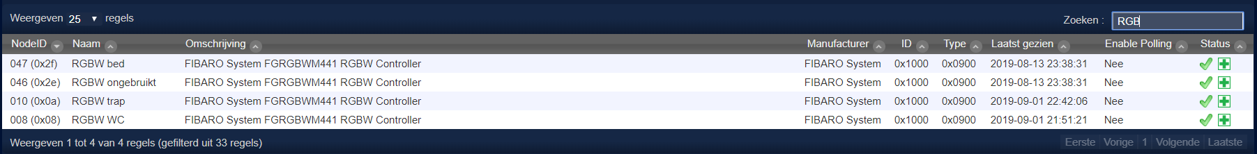

Looks like the command is ignored or the device bugged, so let's compare the version.
FIBARO System 0x1000 0x0900

Mine are all the same ID 0x1000 type 0x0900
008 and 010 are working great, the other 2 have the flashing behaviour
