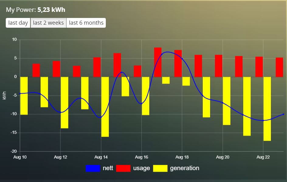

Post by Lokonli »
I've developed a new graph module. As an example, it can generate graphs like the following:
Technical:
I switched from morris.js to chart.js for creating the graphs and added some functionality.
The module is still a bit experimental, and not completely backwards compatible. But I think the new functionality is worth the effort for making the change.
I would like to ask you to help by testing this branch, and to leave your feedback here in this topic.

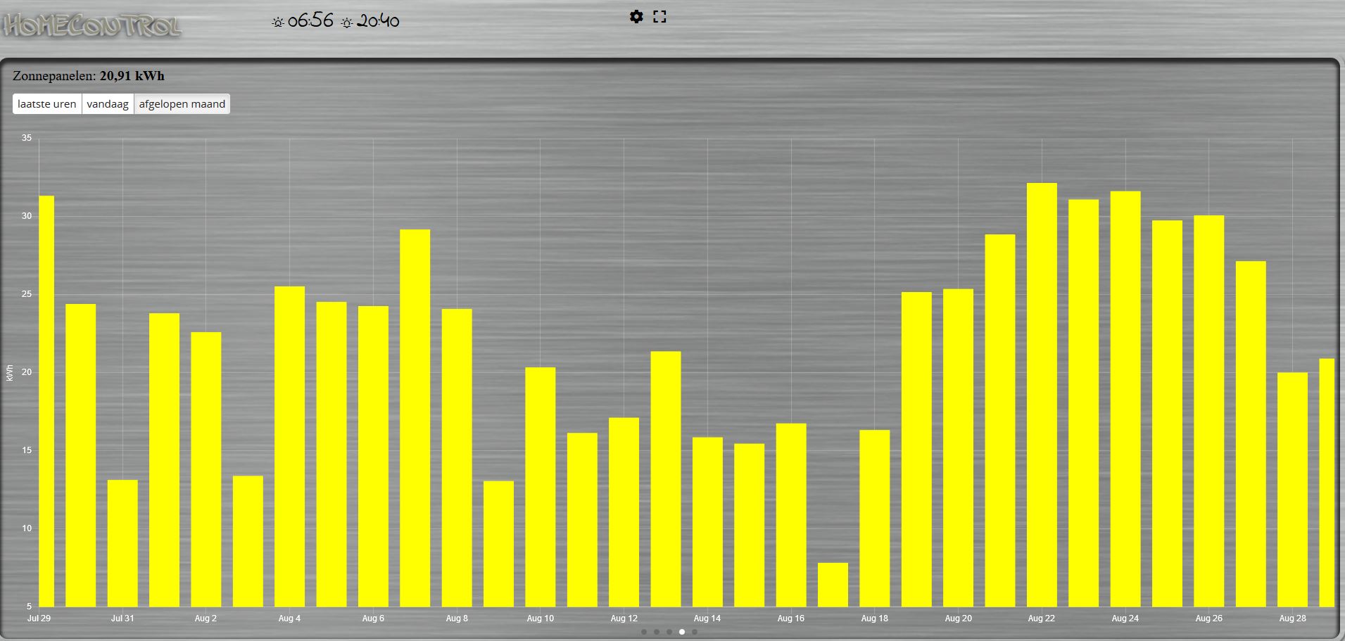

Working, Looks great!
git fetch: no problem (was already on dashticz 3)
first, my graphs were gone, with the initial custom.js .
But after I removed the declarations like
blocks['graph_428'] = {
   title: 'Gas',
   width: 6,
.. the graphs were back, with no data
After modifying to
/*	zonnepaneel	Growatt*/
blocks['graph_1354'] = {
    type: 'bar',
    datasetColors: ['yellow']
/*	P1 power gas*/
    type: 'bar',
/*	P1 power stroom*/
blocks['graph_427'] = {
    width:6
    title: 'My Power',
    graph: ['line','bar','bar'],
    custom : {
        "last day": {
            range: 'day',
            filter: '8 hours',
            data: {
                nett: 'd.v+d.v2-d.r1-d.r2',
                usage: 'd.v+d.v2',
                generation: '-d.r1-d.r2'
        "last 2 weeks": {
            range: 'month',
            filter: '14 days',
            data: {
                usage: 'd.v+d.v2',
        "last 6 months": {
            range: 'year',
            filter: '6 months',
            data: {
                usage: 'd.v+d.v2',
    legend: true,
    datasetColors:['blue','red','yellow']
result:
Now time for fine tune, looking for a way to change size... let's see....
