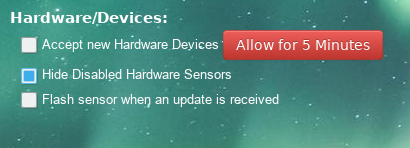

Did you tick the box "Accept new Hardware Devices" or did you allow Domoticz to read New Hardware/Devices for 5 minutes?
See setup ==> Settings
