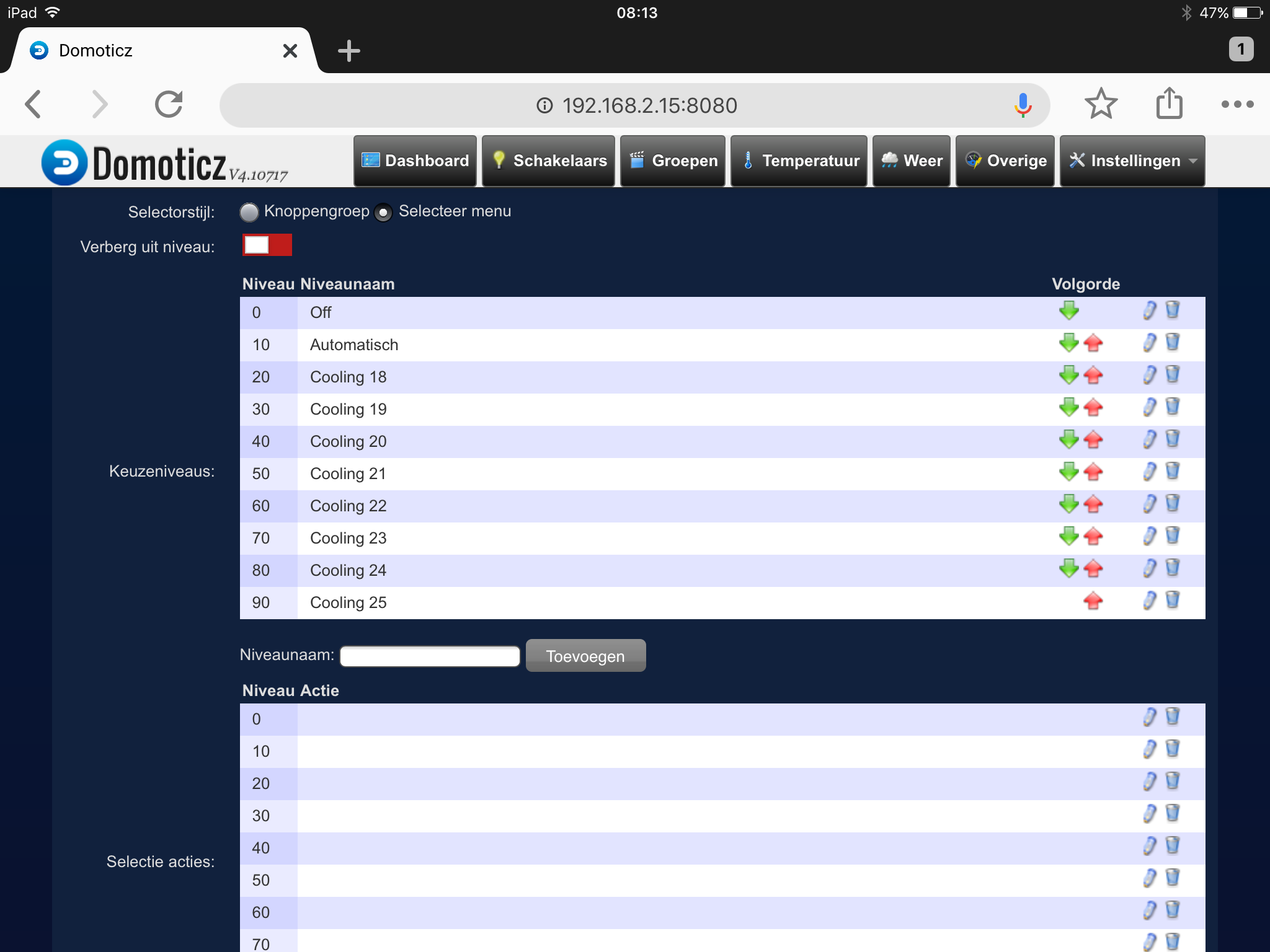

Looks like this
And make a blockly that the selector switch know what action to do

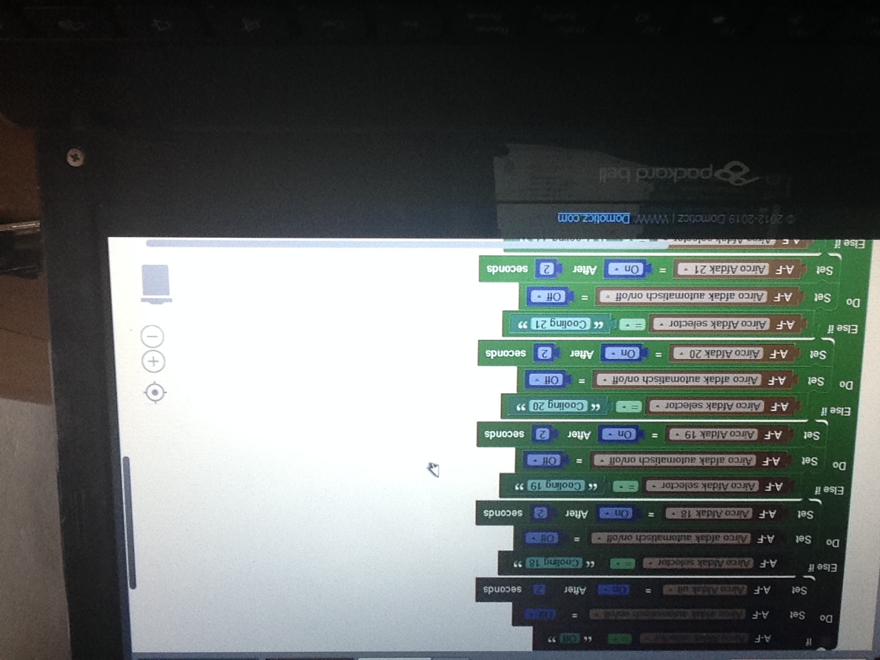

Here the blockly,
Sorry for the bad picture

Thankyou, in the 1st picture where have you created that list

Re: Blockly and user variables for basic heater
hello.
go to hardware than make a dummy device (selector) than you can see them in devices
go to the device you have make and change the settings
alarm_guy1
- Posts: 132
- Joined: Tuesday 14 January 2014 0:03
Cheers got it now
