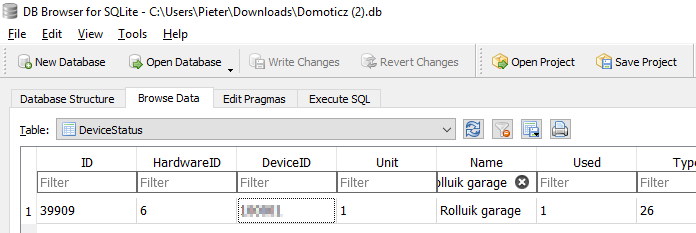

In fact... stupid me! I had downloaded a backup of the database from domoticz and read it with DBBrowser for SQLlite.
It never came into my mind that the answer was in front of me :lol:
2019-07-24 21_27_46-DB Browser for SQLite - C__Users_Pieter_Downloads_Domoticz (2).db.png
2019-07-24 21_27_46-DB Browser for SQLite - C__Users_Pieter_Downloads_Domoticz (2).db.png (19.04 KiB) Viewed 1550 times
Thanks anyway for the command line solution!
