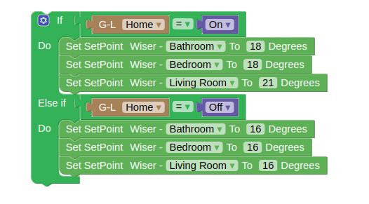

I have tried using a blockly to update the Wiser setpoints but get an error
2019-11-20 21:19:43.971 Error: (Wiser) Transport is not connected, write directive to 'WiserCmd' ignored.
2019-11-20 21:19:52.939 Error: (Wiser) No transport, write directive to 'WiserCmd' ignored.
2019-11-20 21:19:54.943 Error: CConnection_connect, connect request from 'Wiser' ignored. Transport is connecting.
If i update the setpoints manually from the utilities tab they update fine with no errors in the log
Cheers
Chris

Hmm, I think this one is going to be more interesting. Can you set debugging to "connections+Python" and then post the log around the time the script runs please?
Also, just a hunch, but are you trying to update setpoints on multiple rooms at once? If so, could you try what happens if you only update one?
The time stamps on your messages are several seconds apart, which I think has something to do with the problem, but I'm not yet sure what.

Actually, if you can post your blockly script then I can test it locally.

That log is with the latest version of your plugin running i first of all switched the newly created device 'Wiser - Channel-1' on and then off.
I then switched my 'Home' switch off and then on again to trigger the blockly below
I hope that this is of some use
Please let me know if you want anything else
Chris
