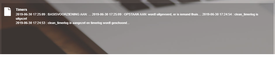

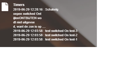

Hi, i made one script for all my timers and groups with dzvents, so no domoticz timers and groups..
after a manual event or a timed event groups of switches are executed and switches for my dayly cycle (sun op, wake up breakf, etc are put to on-off.. works very nice!
i also made my own logging, not for errors and sensor info, only clear results..
With these rules i can log to domoticz and to my own logging...
for each group of devices: msgtxt = 'LAATSTE SCENES gereset ...'
and at the end of my script:
dz.log('Script: ' .. info.scriptName .. ', device: ' .. item.name .. ' ' .. msgtxt, dz.LOG_INFO)
timertekst = dz.time.rawDate .. ' ' .. dz.time.rawTime .. ' : ' .. msgtxt .. '<br>' .. dz.devices('timerlog').text
dz.devices('timerlog').updateText(timertekst)
Question
In the script below there can be executed more then one scenes/groups.. so my msgtxt is overwritten and only the last one is executed in the log
So i need:
- an array for setting msgtxt
- and a construct that reads all defined msgtxt(1-n) (see the end of my script)
Can somebody give a hand? Script is working more than fine! almost finished

            msgtxt = 'BASISVOORZIENING AAN...'
    if (
        (item.isTimer and (item.trigger == OnTimer1 or item.trigger == OnTimer2))       -- BASISVOORZIENING UIT bij einde avond
        or (item.isDevice and item.name == 'Schakelgroepen'  and (item.state == 'Uit' or item.state == 'Slapen' or item.state == 'Uit huis'))                  -- ACTIVEREN bij handmatig Uit, Slapen en Uit huis
        ) then
            dz.devices('boiler').switchOff()
            dz.devices('printer').switchOff()
    if (
        (item.isTimer and (item.trigger == OnTimer8 or item.trigger == OnTimer9 or item.trigger == OnTimer10))  -- START ONTBIJTEN
        or (item.isDevice and item.name == 'Schakelgroepen'  and (item.state == 'Aan'  or item.state == 'Ontbijten'))
        ) then
        dz.devices('Ontbijten').switchOn()
	    if  dz.devices('Jablotronenabled').state == 'Unlocked' then                          -- huis is van alarm, er is iemand thuis
        	if dz.devices('Zon onder').state == 'On' then -- als de zon nog niet op is
                dz.devices('Achtertuin huis terraslamp').switchOn()
                dz.devices('Lamp dressoir links').switchOn()
                msgtxt = 'ONTBIJTEN wordt uitgevoerd, want er is iemand thuis en het is nog donker...'
                msgtxt = 'ONTBIJTEN wordt niet uitgevoerd, want de zon is op ....'
        elseif  dz.devices('Jablotronenabled').state == 'Locked' then                                -- huis op alarm, iedereen is weg, dus niets aanzetten
            msgtxt = 'ONTBIJTEN wordt niet uitgevoerd, want er is niemand thuis....'
    if (
        (item.isTimer and (item.trigger == OffTimer8 or item.trigger == OffTimer9 or item.trigger == OffTimer10))    -- EINDE ONTBIJTEN
        or (item.isDevice and item.name == 'Schakelgroepen'  and item.state == 'Uit')
            ) then
        dz.devices('Ontbijten').switchOff()
        dz.devices('Achtertuin huis terraslamp').switchOff()
        dz.devices('Lamp dressoir links').switchOff()
        msgtxt = 'ONTBIJTEN is afgelopen ...'
    if (
        (item.isDevice  and item.name == 'Schakelgroepen' and item.state == 'Uit')                                                                     -- RESET VAN DE LAATSTE SCENES BIJ handmatig UIT, rest is al gereset
            ) then
            dz.devices('Uit huis').switchOff()
            dz.devices('Thuis').switchOn()
            dz.devices('Uit huis').switchOn()
            dz.devices('Thuis').switchOff()
        if dz.time.isNightTime then                                                             -- als de zon nog niet op is
            dz.devices('Zon op').switchOff()
            dz.devices('Zon onder').switchOn()
            dz.devices('Zon op').switchOn()
            dz.devices('Zon onder').switchOff()

Re: need a loop for reading messages for logging
pvklink wrote: Friday 28 June 2019 18:33 In the script below there can be executed more then one scenes/groups.. so my msgtxt is overwritten and only the last one is executed in the log
So i need:
Please have a look at this one.
-- dit script draait bij avond slapen, zon op, ontbijten, van huis, thuis en opstaan, uit huis thuis
local OnTimer1      = '15 minutes before sunset on mon,tue,wed,thu,fri,sat,sun'         -- HUIS SFEERVERLICHTING AAN
local OnTimer2      = '15 minutes after sunset on mon,tue,wed,thu,fri,sat,sun'          -- TUIN SFEERVERLICHTING AAN
local OffTimer1     = 'at 23:00 on mon,tue,wed,thu,sun'                                 -- EINDE AVOND ALLES UIT DOOR DE WEEK
local OffTimer2     = 'at 23:45 on fri,sat'                                             -- EINDE AVOND ALLES UIT IN HET WEEKEND
local OnTimer3      = 'at 23:05 on mon,tue,wed,thu,sun'                                 -- SLAPEN START door de week
local OnTimer4      = 'at 23:50 on fri,sat'                                             -- SLAPEN START in het weekend
local OffTimer3     = 'at 06:08 on mon,tue,thu,fri'                                     -- EINDE SLAPEN peter
local OffTimer4     = 'at 07:08 on mon,tue,wed,thu,fri'                                 -- EINDE SLAPEN MO
local OnTimer5      = 'at 06:10 on mon,tue,thu,fri'                                     -- OPSTAAN peter
local OnTimer6      = 'at 07:10 on mon,tue,wed,thu,fri'                                 -- OPSTAAN mo
local OffTimer5     = 'at 06:15 on mon,tue,thu,fri'                                     -- EINDE OPSTAAN peter
local OffTimer6     = 'at 07:25 on mon,tue,wed,thu,fri'                                 -- EINDE OPSTAAN mo
local OnTimer7      = '2 minutes after sunrise on mon,tue,wed,thu,fri,sat,sun'          -- ZON OP
local OffTimer7     = '2 minutes after sunset on mon,tue,wed,thu,fri,sat,sun'           -- ZON ONDER
local OnTimer8      = 'at 06:13 on mon,tue,thu,fri'                                     -- ONTBIJTEN AAN PETER
local OnTimer9      = 'at 07:20 on mon,tue,wed,thu,fri'                                 -- ONTBIJTEN AAN MO
local OnTimer10     = 'at 09:20 on sat,sun'                                             -- ONTBIJTEN AAN WEEKEND
local OffTimer8     = 'at 06:44 on mon,tue,thu,fri'                                     -- ONTBIJTEN UIT PETER
local OffTimer9     = 'at 08:00 on mon,tue,wed,thu,fri'                                 -- ONTBIJTEN UIT MO
local OffTimer10    = 'at 11:00 on sat,sun'                                             -- ONTBIJTEN UIT WEEKEND
    on = {  devices = {'Schakelgroepen','Jablotronenabled'},
            timer = {OnTimer1, OnTimer2, OnTimer3, OnTimer4, OnTimer5, OnTimer6, OnTimer7, OnTimer8, OnTimer9, OnTimer10, OffTimer1, OffTimer2, OffTimer3, OffTimer4, OffTimer5, OffTimer6, OffTimer7, OffTimer8, OffTimer9, OffTimer10}
    logging =   { level   = domoticz.LOG_DEBUG,
                  marker  = "Timers"},
    execute = function(dz,item,info)
        local messages = {}
        local function addMessage(message)
            local trigger =  item.isDevice and (", Device: " .. item.name ) or (", Timer: " .. item.trigger)
            messages[#messages + 1] = {}
            messages[#messages].log  = 'scriptname: ' .. info.scriptName .. trigger .. ' ' .. message
            messages[#messages].text = dz.time.rawDate .. '  ' .. dz.time.rawTime .. ' : ' .. message
        local function dumpMessages()
            local textDevice = dz.devices('timerlog')
            local currentText = textDevice.text
            local newText = currentText
            for i, record in ipairs(messages) do
                dz.log(record.log, dz.LOG_INFO)
                newText = record.text .. '<br>' .. newText
            if newText ~= currentText then
               textDevice.updateText(newText)

YESSSS , that works great!
Only my rules are not on one line and some leters are missing?
pvklink wrote: Saturday 29 June 2019 12:33 YESSSS , that works great!
OK please try and change
local lf = '<br>'
to
local lf = '\n'
pvklink
Posts: 822
Joined: Wednesday 12 November 2014 15:01
Domoticz version: latest b
Post by pvklink »
that gives:
019-06-29 14:41:37.991 Status: EventSystem: Script event triggered: /home/pi/domoticz/dzVents/runtime/dzVents.lua
2019-06-29 14:41:37.990 Error: dzVents: Error: (2.4.23) Timers: An error occurred when calling event handler DZ_schakelgroepen
2019-06-29 14:41:37.990 Error: dzVents: Error: (2.4.23) Timers: /home/pi/domoticz/scripts/dzVents/scripts/global_data.lua:51: invalid value (nil) at index 3 in table for 'concat'
Jablotron connection, Ikea
pvklink
Posts: 822
Post by pvklink »
When i remark those 2 lines in global_data.lua, the result is looking better..
--lines = dz.utils.stringSplit(newText, lf) -- create lines table from newText string
--newText = table.concat(lines, lf, 1, maxLines) -- recreate newText string from first maxLines
pvklink wrote: Saturday 29 June 2019 14:44 that gives:
can you try this one ?

dit one is much better, uses the whole textswitch. Only an enter missing after a rule....

pvklink wrote: Sunday 30 June 2019 17:28 This one is much better, uses the whole textswitch. Only an enter missing after a rule....
I cannot reproduce this behavior. The helper function does add a CR/LF between the messages. What is the user interface theme where you see this ?
Post by pvklink »
the default theme in dashtics
pvklink wrote: Sunday 30 June 2019 18:55 the default theme in dashtics
And what do you see in the device in the domoticz Gui ?
Could it be that dashticz behaves different on a LineFeed then domoticz does ?
