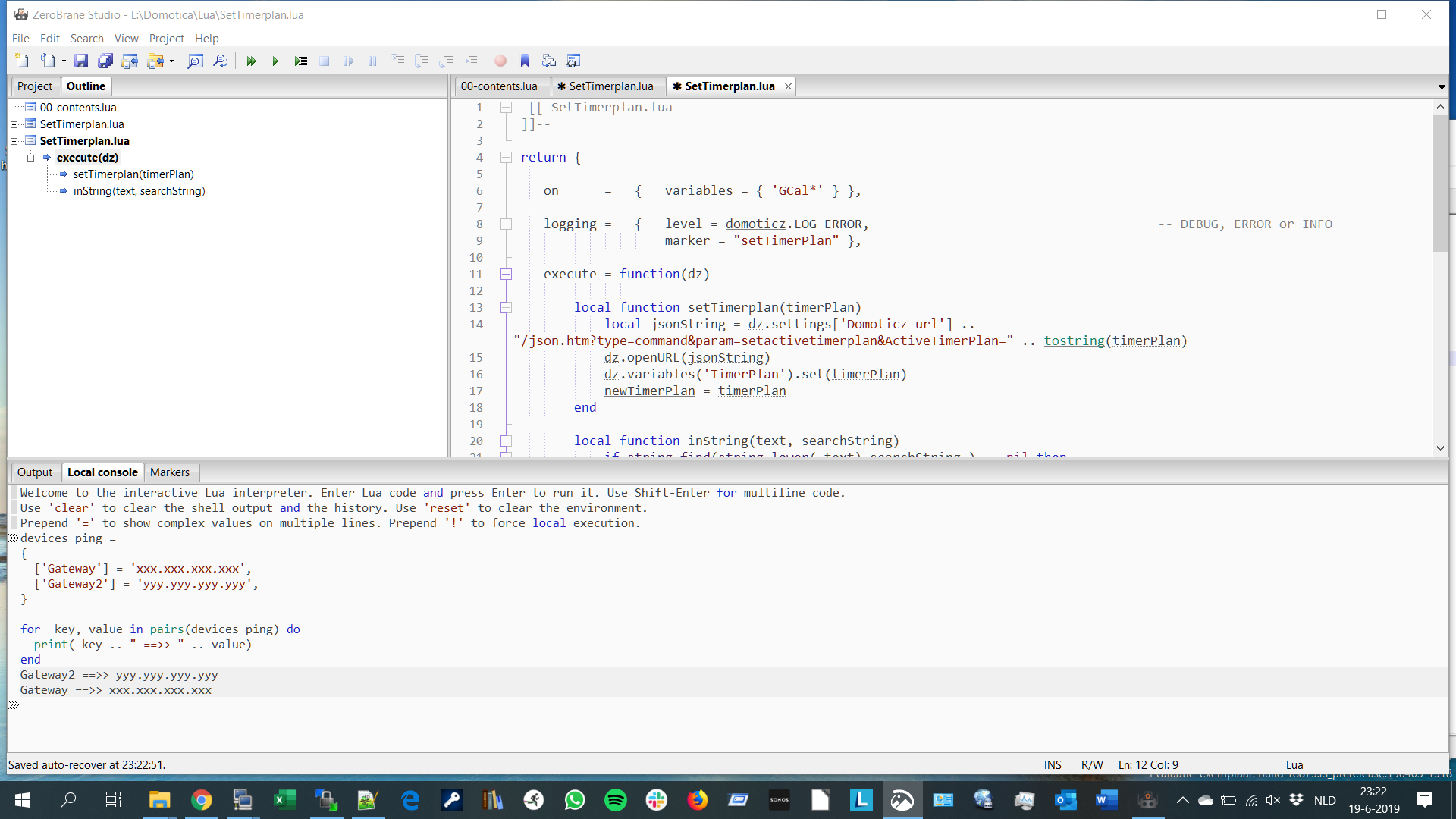

you can practice this type of constructs also on the CLI if you installed Lua on your PI
sudo apt install lua5.2
Have a look at this example of the 'in pairs' construct
#lua
Lua 5.2.4  Copyright (C) 1994-2015 Lua.org, PUC-Rio
 devices_ping =
>>   ['Gateway'] = 'xxx.xxx.xxx.xxx',
>>   ['Gateway2'] = 'yyy.yyy.yyy.yyy',
>for  key, value in pairs(devices_ping) do
>>   print( key .. " ==>> " .. value)
>>end
Gateway ==>> xxx.xxx.xxx.xxx
Gateway2 ==>> yyy.yyy.yyy.yyy
Or use a Lua IDE on your desktop (ZeroBrane or another)
ZeroBrane IDE
ZeroBrane IDE
