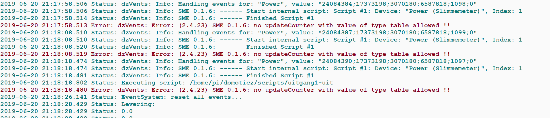

i have found several methods but something is going wrong..
trying to get 1 value stored...
- Nieuw tekstdocument.txt
- (2.54 KiB) Downloaded 54 times
- Knipsel.PNG (137.78 KiB) Viewed 1760 times
- waaren
- Posts: 6028
Re: P1 counter value math
This message is about dzVents recognize the situation that the script wants to put a table value in the sValue field of a device which would lead to a crash off domoticz. So dzvents will not allow this to happen.StefanWouters wrote: Thursday 20 June 2019 21:25 i have found several methods but something is going wrong..trying to get 1 value stored...
Please remove the -- from line 20.
The script will then produce some extra log lines which might make it easier to understand what is happening.

2019-06-20 22:44:59.147 EventSystem: Event triggered: Script #6 stop eerste vrijgave_1
2019-06-20 22:44:59.021 Status: dzVents: Info: Handling events for: "Power", value: "24086340;17373198;3070180;6587818;748;0"
2019-06-20 22:44:59.021 Status: dzVents: Info: SME 0.1.6: ------ Start internal script: Script #1: Device: "Power (Slimmemeter)", Index: 1
2019-06-20 22:44:59.022 Status: dzVents: Debug: SME 0.1.6: Processing device-adapter for Test7: Counter device adapter
2019-06-20 22:44:59.023 Status: dzVents: Debug: SME 0.1.6: Gebruik laag = 24086340
2019-06-20 22:44:59.023 Status: dzVents: Debug: SME 0.1.6: Processing device-adapter for Test8: Counter device adapter
2019-06-20 22:44:59.023 Status: dzVents: Debug: SME 0.1.6: Gebruik hoog = 17373198
2019-06-20 22:44:59.024 Status: dzVents: Debug: SME 0.1.6: Processing device-adapter for Test9: Counter device adapter
2019-06-20 22:44:59.024 Status: dzVents: Debug: SME 0.1.6: Levering laag = 3070180
2019-06-20 22:44:59.025 Status: dzVents: Debug: SME 0.1.6: Processing device-adapter for Test10: Counter device adapter
2019-06-20 22:44:59.025 Status: dzVents: Debug: SME 0.1.6: Levering hoog = 6587818
2019-06-20 22:44:59.026 Status: dzVents: Debug: SME 0.1.6: Processing device-adapter for Test11: Counter device adapter
2019-06-20 22:44:59.026 Status: dzVents: Debug: SME 0.1.6: Actuele Gebruik = 748
2019-06-20 22:44:59.026 Status: dzVents: Debug: SME 0.1.6: Processing device-adapter for Test12: Counter device adapter
2019-06-20 22:44:59.027 Status: dzVents: Debug: SME 0.1.6: Actuele Levering = 0
2019-06-20 22:44:59.027 Status: dzVents: Debug: SME 0.1.6: Processing device-adapter for Uitgang 4: Switch device adapter
2019-06-20 22:44:59.027 Status: dzVents: Debug: SME 0.1.6: Constructed timed-command: Off
2019-06-20 22:44:59.028 Status: dzVents: Debug: SME 0.1.6: Processing device-adapter for Test14: Counter device adapter
2019-06-20 22:44:59.029 Status: dzVents: Info: SME 0.1.6: ------ Finished Script #1
2019-06-20 22:44:59.128 Status: Levering:
2019-06-20 22:44:59.128 Status: 0.0
2019-06-20 22:44:59.128 Status: Verbruik:
2019-06-20 22:44:59.128 Status: 224.0
2019-06-20 22:44:59.129 Status: 278.0
2019-06-20 22:44:59.129 Status: 246.0
2019-06-20 22:44:59.175 Status: Executing script: /home/pi/domoticz/scripts/uitgang2-uit
2019-06-20 22:44:59.028 Error: dzVents: Error: (2.4.23) SME 0.1.6: no updateCounter with value of type table allowed !!- waaren
- Posts: 6028
OK.StefanWouters wrote: Thursday 20 June 2019 22:43 LogCode: Select all
2019-06-20 22:44:59.175 Status: Executing script: /home/pi/domoticz/scripts/uitgang2-uit 2019-06-20 22:44:59.028 Error: dzVents: Error: (2.4.23) SME 0.1.6: no updateCounter with value of type table allowed !!
53 domoticz.data.counter = domoticz.devices(idxcons).updateCounter(SMdata[5])
54 end
55
56 domoticz.devices (warmtevraag) .switchOff ().checkFirst()
57 domoticz.devices(test3).updateCounter(domoticz.data.counter)
In line 53 domoticz.data.counter is set as a table. In line 57 device 44 is updated with this table. This is not allowed and therefore the script will abort and no devices will be updated.
