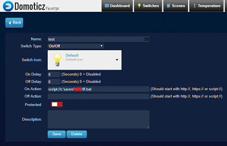

I have been reading for days and am lost on what is supported under script:\\ in a windows environment.
can I call a batch file don't look like it, do I have to use lua to call cmd/batch.
Or is there no support under windows/dos OS.
I'm not strong in unix and run some dos only based sensors "watts clever" power meter so like to stay with windows at this stage.
Thanks,
Paul V.
Re: Batch file in windows environment.
PVerburg wrote: Sunday 09 June 2019 23:54 I have been reading for days and am lost on what is supported under script:\\ in a windows environment.
Yes you can. Do this from the On/Off actions fields and use something like
script://c:\users\<user name>\<bat name>.bat

Thanks, that worked the problem was that the sound command won't work when called in a batch file like that.
will experiment with different options i'm sure i will find the cause.
