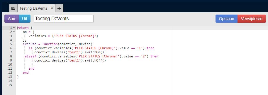

Now i created a small script in DzVents:
There are no errors at all! but script is not working.
Please help me understanding DzVents.
Thxx in advance!!!

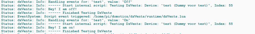

Nothing happend in the log files:
So i thought maybe Dzvents is not working, but with the test script from WIKI:

How do you update the variable ?
You defined the variable as integer but you check if IT is equal to a string.
Please tag your code with code tags, makes it much easier to check.

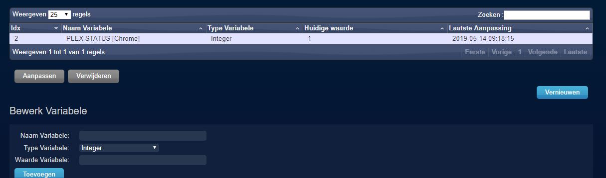

The variable is updated by Python script, bases on evenements happend in plex.
When i check this script with my uservariable is this correct.
But somehow i think that DzVents is not recognize: variables = {'PLEX STATUS [Chrome]'}

From: https://www.domoticz.com/wiki/DzVents:_ ... 7B_..._.7D
variables = { ... }
A list of one or more user variable-names as defined in Domoticz ( Setup > More options > User variables). If any of the variables listed here changes, the script is executed.
So ... is your variable defined there ?
OedzesG
