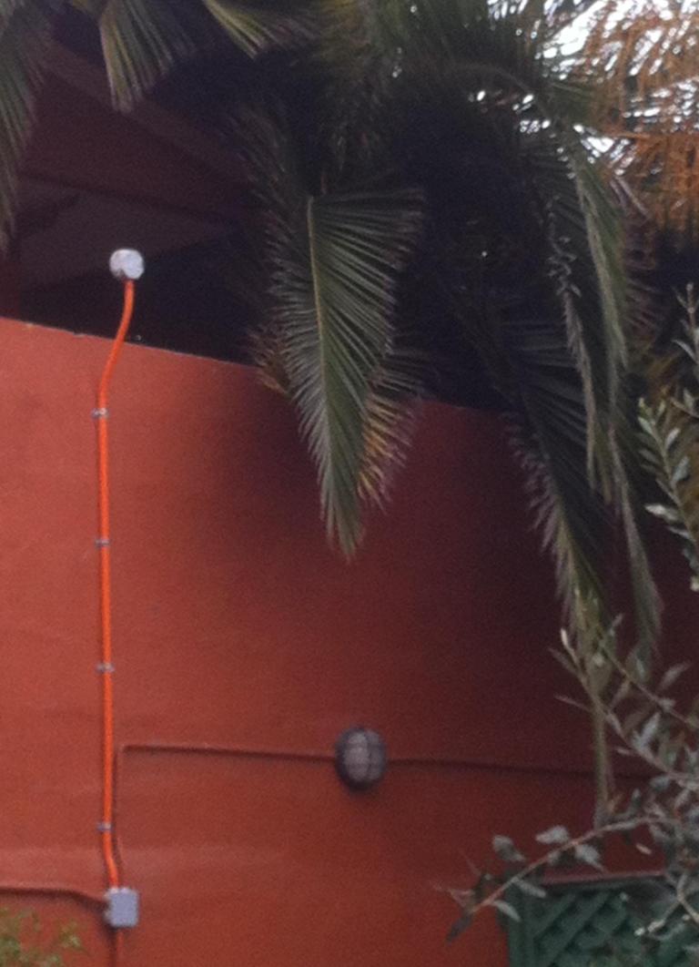

28 metres from the controller behind a thick concrete wall NLOS.....another way to skin a cat.
If you can't go through, go over..
