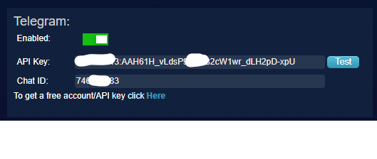

Re: dzvents is using variables from other script
corthebor wrote: Friday 19 April 2019 9:23 About domoticz.notify can natively send a notification to telegram: I looked in to that a while ago, but did not manage to get that working.
in Domoticz [Setup] [Settings] [Notifications]
Telegram setup
Telegram setup
in your dzVents script:
domoticz.notify("Subject", "message",domoticz.PRIORITY_NORMAL,nil,nil,domoticz.NSS_TELEGRAM)
