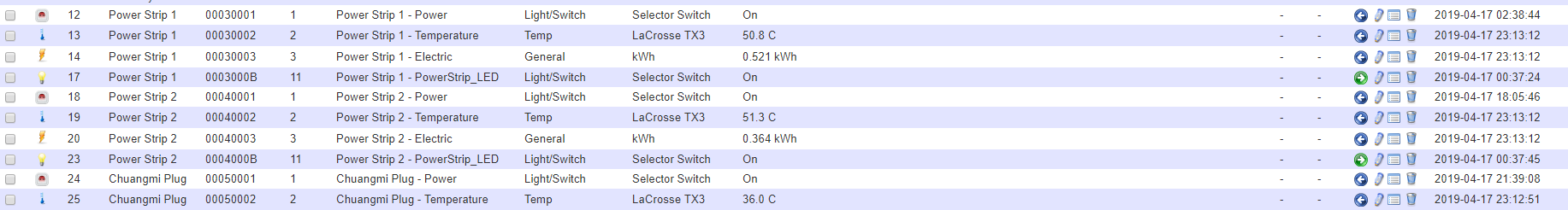

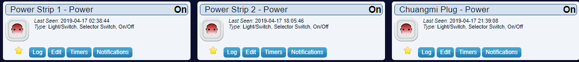

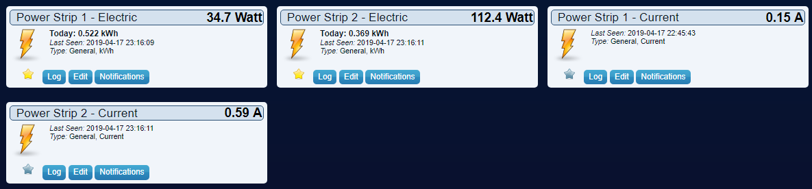

Post by lhitvietnam »
Hi, I found the Power strip connection plugins with Domoticz easily here https://github.com/xiaoyao9184/DomoticzXiaomiPlugins
install plugin
 "curl -L https://github.com/xiaoyao9184/DomoticzXiaomiPlugins/raw/master/install.sh | bash"
Screenshot (4).png (18.78 KiB) Viewed 910 times
