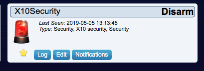

A fast update - I sent the RFXmngr data to RFXcom support this morning and within hours an updated firmware including proper decoding of the Kerui panel was received. Seems to be working - great job, once again!
