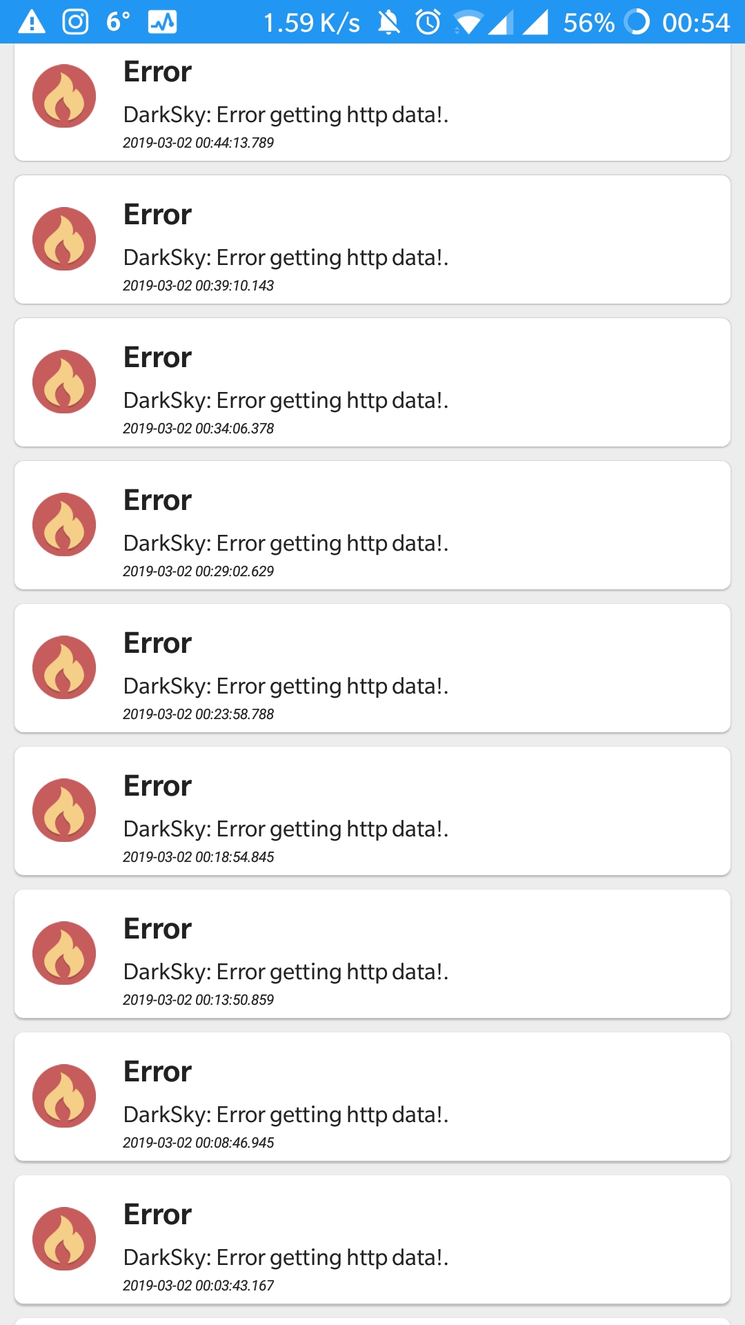

Only the log file of Domoticz say this

Re: Darksky: Problem adding hardware
At least the API key is wrong. You just enter the key there, not a URL. Something like 20cc88b18c30ca7cc5d2c8726ggb8c23. Maybe you need to also allow new devices before hitting "add"/"update" unless you have them allowed by default.witteherder wrote: Thursday 28 February 2019 13:31 I also did add it but I m not seeing extra devices after that
- waaren
- Posts: 6028
