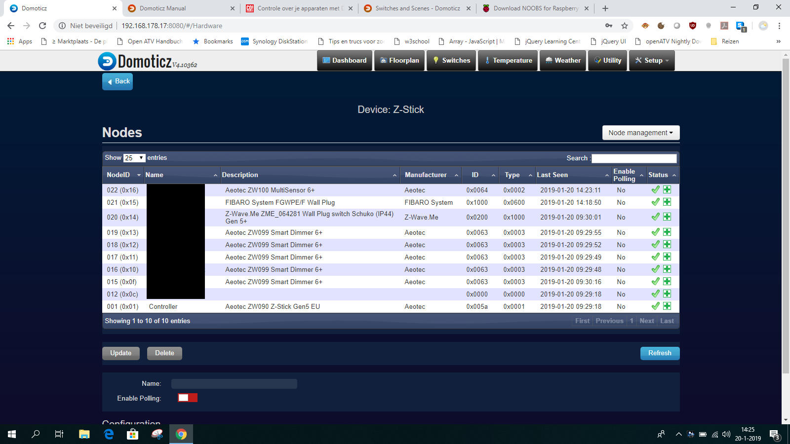

Can you show a screen shot from the hardware and from the devices tab ? That might help to identify the issue.newby2017 wrote: Sunday 27 January 2019 19:04 I ran Domoticz for quite a long time without any issues until my Razberry hat gave up. I then decided to run with the Z-stick-5 from Aeotec on a new 4.9700 Stable install. Reinstalled all RfxCom and Z-wave devices. When installing all devices show up on the switches tab, including the Aeotec dimmers. The RfxCom thermometer was in the temperature tab as it should be.

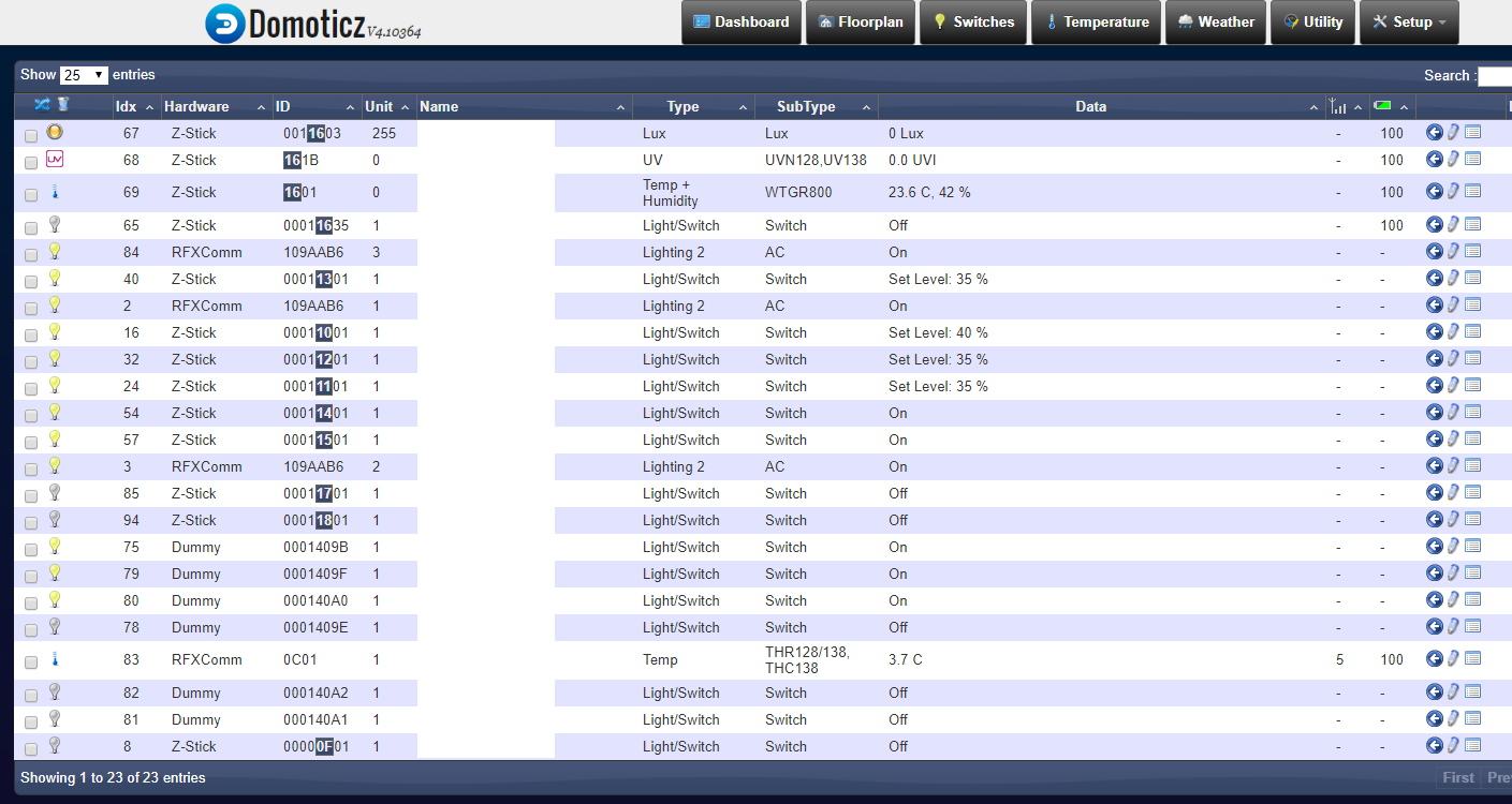

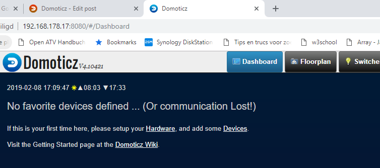

As requested some screen shots. I've not bothered to add more devices as they will keep disappearing. So I figured better to wait till the issue is solved.
I guess with the proposed thread you want me to check the dbase? I don't mind, but I've reinstalled Domoticz from scratch including the raspberry Jessie image multiple times even on different SD cards without success.
I'll add the dashboard tab in a new reply, 3 files seems to be the max at the forum.

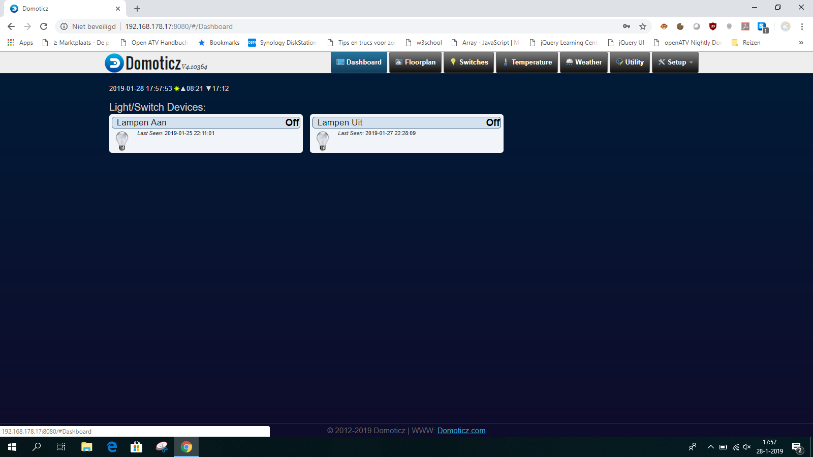

As you can see, only my dummy switches are visible in the switches tab. The rest all gone each and every time.
Also the status ON/OFF is not refreshed on the floorplan when manual activating a device NOR when activated from the floorplan itself. I've tried iE, Edge, Chrome and Safari on an iOS device.
Desperate for help....

Done all, yet no resolution. Checked Dbase with SQLite Expert on a Windows m/c. Nothing reported, Saved it and copied it back to the Raspberery. Still the same results.

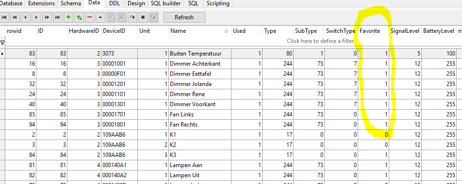

Checked the DBase for favourite and found the following. Does this mean they should appear on the dashboard etc?
Really this is a very weird issue.
BTW The dashboard is still completely empty and "Lampen Aan/Uit" was already gone from the Switches tab before checking the DB.
- dashboard tab.PNG (30.62 KiB) Viewed 3382 times
- switches tab.PNG (70.13 KiB) Viewed 3382 times
- Domoticz.db.png (32.32 KiB) Viewed 3384 times

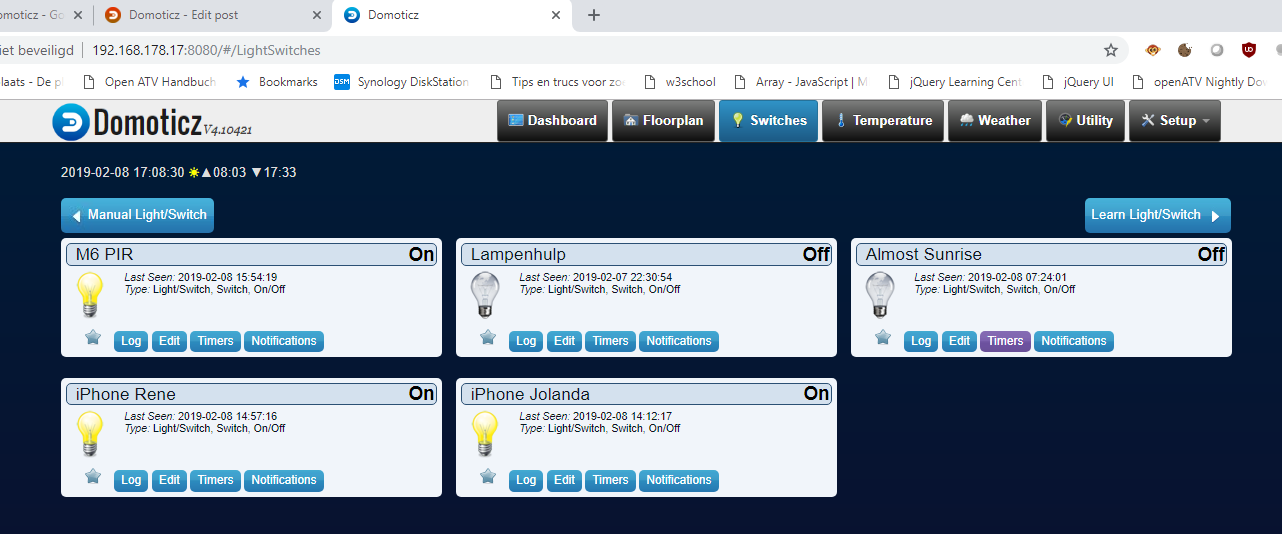

I think I´ve hit the same bug as you but I can't understand what you did to fix it?
thanks
/c
thanks
/c

Re: Devices disappearing from dashboard and other tabs
My first thought as well... but no... this is from incognito mode.
What I did was:
1. Updated to latest Beta.
2. Nothing worked. Found out that Ubuntu 18 wasnt supported anymore
3. Upgraded to ubuntu 20.4
4. Devices gone in favourites and switches. ??
Any ideas?
What I did was:
Any ideas?

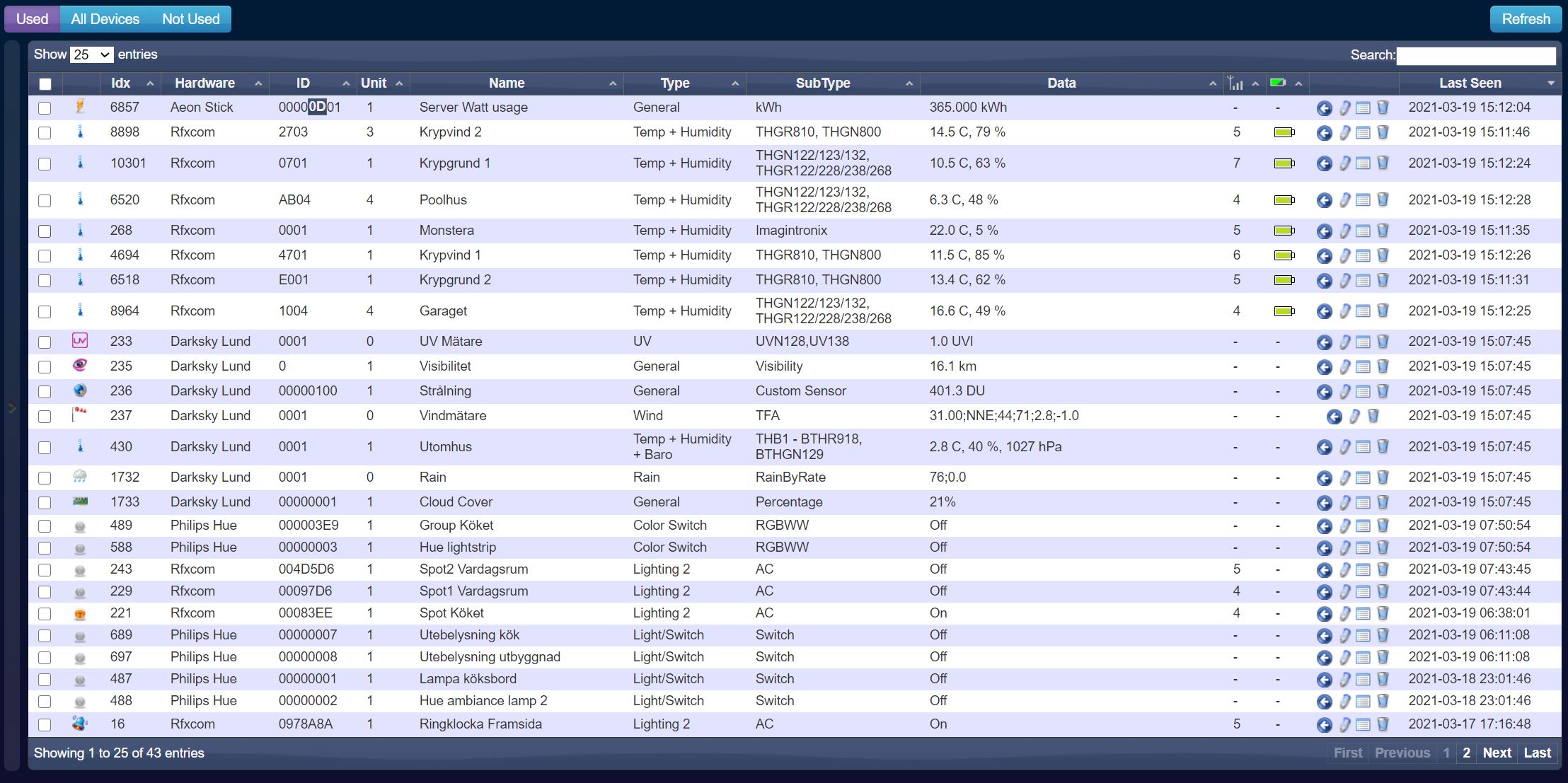

Yes
- domo.JPG (374.14 KiB) Viewed 2507 times
