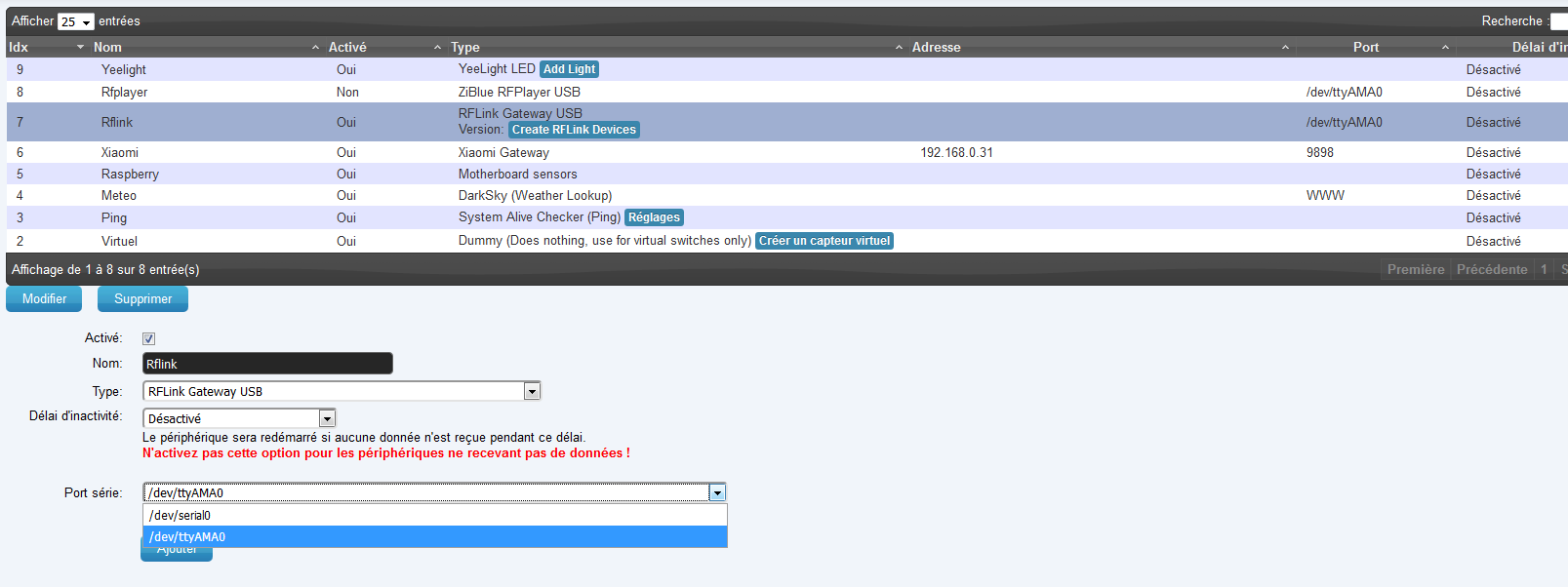

After an update, upgrade and install motion and motion eye (so where is the problem...), my rflink don't want to send any command by domoticz anymore.
If i try to send a command, domoticz tell me to verify hardware and log send me:
2019-01-22 13:21:50.802 Status: User: limabravo initiated a switch command (28/Buffet/Off)
2019-01-22 13:21:50.804 Status: RFLink Sending: 10;TriState;8222a4;10;OFF;
2019-01-22 13:21:55.000 Error: RFLink: TX time out...
I have rflink, rflink (disable) and an hard drive on my pi. And in my hardware i have this, and i don't know how to know wich serial must be use:
Sans titre.png (42.15 KiB) Viewed 2186 times
Someone can help me ?

My arduino work on windows, on r48. I think it work on raspberry to because i see it on dmesg

Maybe another info:
limabravo@raspberrypi2:~ $ sudo lsusb -v | grep 'idVendor\|idProduct\|iProduct\|iSerial'
idVendor 0x18a5 Verbatim, Ltd
idProduct 0x022b Portable Hard Drive (Store'n'Go)
iProduct 11 Portable USB Drive
iSerial 12 29500Y141547
idVendor 0x2341 Arduino SA
idProduct 0x0042 Mega 2560 R3 (CDC ACM)
iProduct 2 (error)
iSerial 220 5563231383835131A1E1
idVendor 0x0403 Future Technology Devices International, Ltd
idProduct 0x6001 FT232 USB-Serial (UART) IC
iProduct 2 RFPLAYER
iSerial 3 A11AHIZU
idVendor 0x0424 Standard Microsystems Corp.
idProduct 0xec00 SMSC9512/9514 Fast Ethernet Adapter
iProduct 0
iSerial 0
idProduct 0x9514 SMC9514 Hub
iProduct 0
iSerial 0
idVendor 0x1d6b Linux Foundation
idProduct 0x0002 2.0 root hub
iProduct 2 DWC OTG Controller
iSerial 1 3f980000.usb
(EDIT:
In my way, i found a tutorial on wiki to make persistent name for usb. But here's one question more:
sudo nano /etc/udev/rules.d/99-usb-serial.rules
