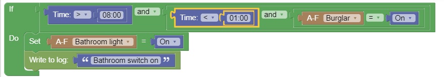

I need to switch on the light by movement at the specified period of time. I have created the event:
Motion sensor question.jpg (35.29 KiB) Viewed 902 times
but it doesn't work at all, if I will delete one "and", all is working fine.
Please advice.

Time > 08:00 and Time < 01:00 are mutual exclusive

I'm not clear about the time frame in which you want le light on...
Expect it would be from 8:00am to 1:00am (so it is 8:00 ==> 24:00 and 00:00 ==> 1:00)
I would try to revert the condition:
if Burglar = on AND (Time > 8:00 OR Time < 1:00)

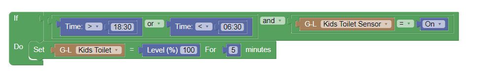

Yep change the and between the times to OR. The time resets at midnight.

If you only change then “and”, the alarm will go off any time after 8 am. You need to swap the Burglar=On block with Time>08:00 and then change the “and” to “or” between both time statements.

Really because i have this one working ok.

Really, it’s exact the same. You changed more than just the and to or, you rearranged some things that made it work.
