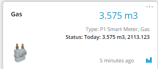

@Joep123, the daily usage of a domoticz gas sensor is a calculated value. In the database only the total is stored and domoticz "knows" the total amount at 0:00 (from another table)
select ID,Name,sValue from deviceStatus where id = 36;
ID|Name|sValue
36|Gas|2113123
select * from meter_calendar where deviceRowid=36 and Date=date("now","-1 day") ;
DeviceRowID|Value|Counter|Date
36|3427|2109548|2018-10-30
2113123
2109548 -
3575
Gas meter (36)
Gas meter (36)
So trying to store GasUsageperDegreesday in a gas sensor device is not going to give you the information you want to see.
