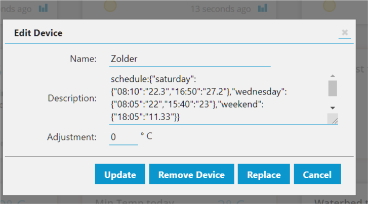

It is not possible to do this on the timer screen. As a workaround I created this dzVents script that will take a string from the description field and process the setpoint accordingly.
Example on how to enter the string in the description field
Further description is in the comments.

Hello waren,
Thanks for your reply. If I try editing my devices I can't find the discription box like in your screenshot??
If I go to devices and try to edit the 3 devices that are visible after adding the "Evihome via web api" hardware are the ones in this screenshot......

TheChief wrote: Saturday 27 October 2018 23:41 ... If I try editing my devices I can't find the discription box like in your screenshot??
You have to use the edit button on your device on the temperature or utility tab
http://domoticz_IP:domoticz_PORT/#/Temperature or http://domoticz_IP:domoticz_PORT/#/Utility

Yes. Just edit the line
local allSetpoints         = {"EvoTouch","EvoTouch2","Zolder"}  -- all evo devices (minimal 1)
in such a way that it contains all setpoint devices that you want to control with this script and in all these devices put the string
schedule:{"saturday":{"08:10":"22.3","16:50":"27.2"},"wednesday":{"08:05":"22","15:40":"23"},"weekend":{"17:25":"41.33"}}
in the description field (modified to suit your requirements )
