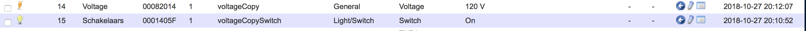

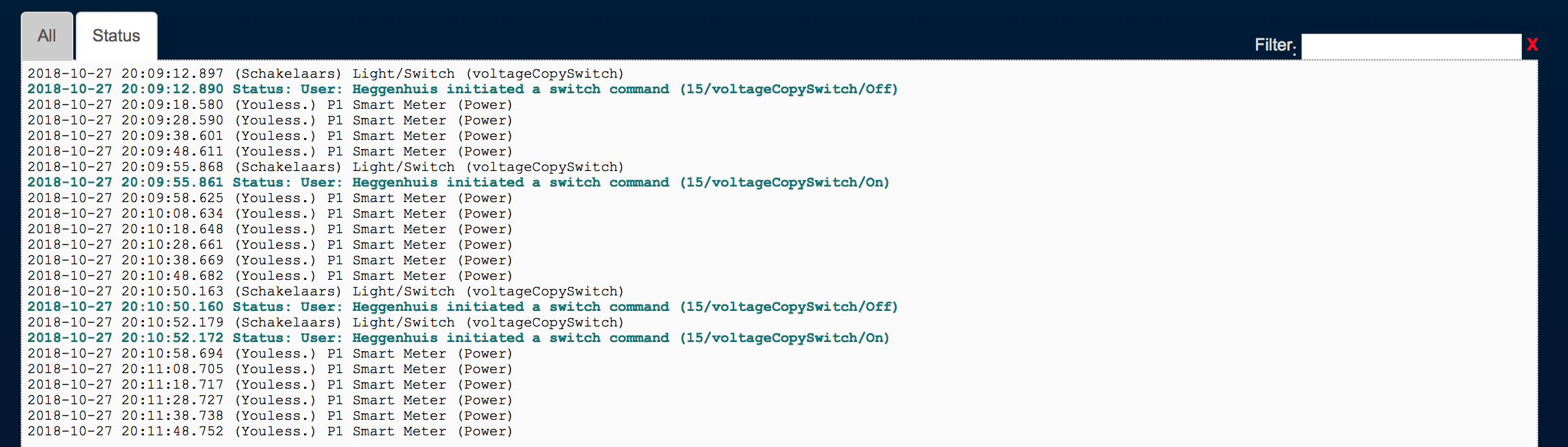

I tried this latest code with a fresh installed Domoticz, so only this code and the new IDX
IDX 14 is the master voltage sensor, were I can read now the value 80.
IDX 13 is the slave sensor, and I read now the value "0".
IDX 15 is the voltage Switch and I with it on and off serval times. Also tried when the switch is on change the value off IDX 14 master voltage.
But no copy from IDX 14 to IDX15.
Do I something wrong?
Here is my log
Here is my log

- waaren
- Posts: 6028
Re: Analog measurement
As you described it, the copy should go from 14 to 13Knibor wrote: Saturday 27 October 2018 20:14 Hi,
Here is my log
Can you show the script how it is now and at least show the log with the debug lines of the script? Preferable in textformat within "[ code]" "[ \code]" tags
