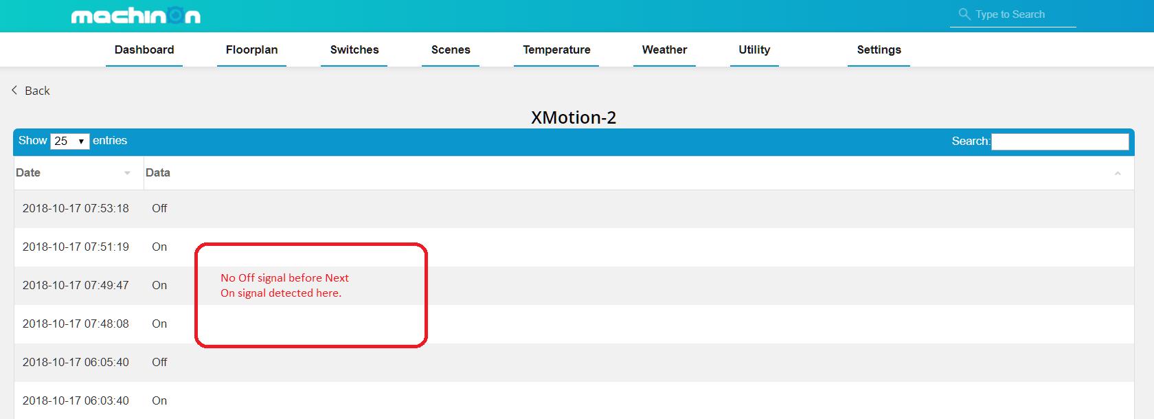

Not sure if it is the same sensor and if something can be configured in these sensors but the log of my xiaomi motion sensor does not show the behavior that you describe.
loglines of one of my xiaomi motion sensors
But maybe for your situation this works better.

Re: The light stays on while there is movement.
The setting in the Off delay field explains why you see a different behavior. If you leave that out the sensor.state won't go to "Off" while there is movement detected.
So if you want to keep that Off delay of 60 seconds you should use the 2nd script. If you take it out the first script will do.
