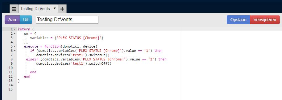

Hallo everyone!
Anny news on this?
I have a Plex script (python) witch updates my user variable, but when it changes (for example: Movie Pause) it is not triggering DzVents.

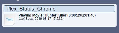

Re: Variable doesn't trigger script
Post by OedzesG »
The script is updating a text device, but i dont know if i can get my trigger out of it!
Sorry, im not an expert in python cripting.
Exapple:
No media.JPG (14.65 KiB) Viewed 3144 times

OedzesG wrote: Friday 17 May 2019 17:24 The script is updating a text device, but i dont know if i can get my trigger out of it!
Can you please share the Python and dzVents scripts (and please use code tags </>) related to this question here ?

And this is the script..
I am just started with domoticz, so hope the script is oke!?

OedzesG wrote: Friday 17 May 2019 17:34 And this is the script..
Can you try this ?
        on = {  devices = { 'Plex_Status_Chrome' }},
    logging =   {   level   =   domoticz.LOG_DEBUG,
                    marker  =   "plexTest" },
    execute = function(dz)
        plexVar = dz.variables('PLEX STATUS [Chrome]')
        testSwitch = dz.devices('test1')
        if tostring(plexVar.value) == '1' then
            testSwitch.switchOn()
        elseif tostring(plexVar.value) == '2' then
            testSwitch.switchOff()
        dz.log('Value of vatiable ' .. plexVar.name .. " is " .. plexVar.value,dz.log_DEBUG )
OedzesG
Posts: 106
Joined: Monday 11 March 2019 0:14
Post by OedzesG »
IT WORKS !!! amazing!!!
But.......... the script is updating every X seconds, so my log is going crazy right now.
OedzesG wrote: Friday 17 May 2019 18:18 But.......... the script is updating every X seconds, so my log is going crazy right now.
It only means that the text sensor is updated (very) frequently. If you don't wan't to fill your log and only send a command to the switch when it should change state then adjust script to
    logging =   {   level   =   domoticz.LOG_ERROR,
            testSwitch.switchOn().checkFirst()
            testSwitch.switchOff().checkFirst()
        -- dz.log('Value of vatiable ' .. plexVar.name .. " is " .. plexVar.value,dz.log_DEBUG )
