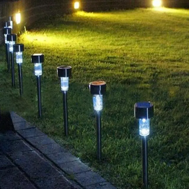

Thanks for sharing, really great idea, and it is working out of the box!
the basic parts are working, yeah!
now i want to integrate it into something like this:
maybe i can add some more sensors to it?
