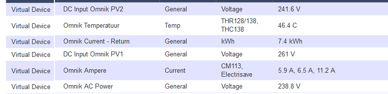

The following should be possible with Omnik Inverter:
