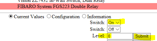

I looked through those commandclass settings but none seem to apply. I did learn something new, though. The light does turn on/off when I submit a command through the control panel.
Domoticz logs that command differently It logs (Aeotech Z-Stick) Light/Switch (Switch)
Whereas when I press the dashboard widget appears to send the wrong command and logs it as OpenZWave: Domoticz has send a Swtich command!, Level:255 ... So, Domoticz is definately doing somethg different and sending an incorrect command. I'm not sure how to fix it. I looked at the fibaro/fgs223.xml and the begining of the file has:
<!--COMMAND_CLASS_SWITCH_MULTILEVEL. This class is in the list reported by the device, but it does not respond to requests -->
<CommandClass id="38" getsupported="false"/>
I tried changing the CommandClass to "37" - binary switch then excluding and including the fgs223 again. It didn't seem to affect anything. But I'm still figuring this stuff out - like how Domoticz decides when to send dimmer command vice on/off command so I don't know what to do next.

I have the same problem as Virtualfreak on switch 1, switch 2 works correctly. I tried to exclude and include the releays several times but without getting positive results.

I have the same issue, switch 1 not responding, but 2 working fine and rebooting doesn't work.
Did anyone solve it?

I also have one dbl switch fgs-233 with only one button working. I have tried reboot and exclude/include the device. It works when I press the physical buttons but not in domoticz.
