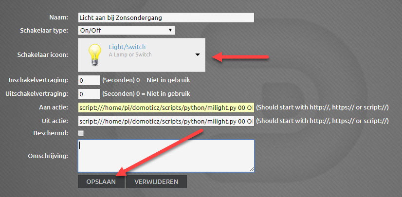

Anyway: Made a virtual Switch for dusk to dawn functionality for the light but I cannot Save or edit it.
Followed instruction provided by Strontvlieg: Control your miLights iBox2 V6 with Domoticz
Last thing to do and where I'm stuck is getting the script in and save:
ON action dummy switch: script:///home/pi/domoticz/scripts/python/milight.py 00 ON
OFF action dummy switch: script:///home/pi/domoticz/scripts/python/milight.py 00 OFF
It seems I'm not able to change the icon (and save) or even upload a new custom icon for that matter.
Is this a bug or am I missing something? It's a fresh Domoticz and fresh debian stretch install. I'm stuck, any help wil be great.

I did a complete new install on my Raspberry Pi 3B+. Latest Rasbian Stretch version from: https://www.raspberrypi.org/downloads/raspbian/.
Integraded all updates en installed latest Node = 10.4.1 and NPM = 6.1.0
Installed latetst Domoticz but had to do an upgrade to beta because Domoticz was offline (source: viewtopic.php?t=23070)
Version: 3.9639
Build Hash: 786b9638
Compile Date: 2018-06-14 16:44:52
dzVents Version: 2.4.6
Python Version: 3.5.3 (default, Jan 19 2017, 14:11:04) [GCC 6.3.0 20170124]
I am a little disappointed at this point. No result after all my efforts. Any ideas guys?

Solved it!
In this post (http://www.domoticz.com/forum/viewtopic.php?t=22903) was the answer I was looking for.
I deleted the domoticz.js.gz file and all is fixed.
Thanx guys!
Strange how Debian handels this.First of all, please make sure you're using latest beta, there were a few UI bugs fixed in the first few days after the reworked color dimmer stuff was introduced.
Then please delete www/js/domoticz.js.gz from your Domoticz installation directory if it exists.
Do NOT delete www/js/domoticz.js, that file is needed, Domoticz Web UI will not work without it.
Finally, do a forced refresh of the appcache:
For Chrome:
Open the developer console, select the network tab, refresh the page
right click on an item in the network tab, select 'clear cache'
Next clear the appcache, navigate to chrome://appcache-internals/
If this helps, please report "Build Hash" version, found on page /#/About (Setup->About in web UI) and confirm if www/js/domoticz.js.gz was present
