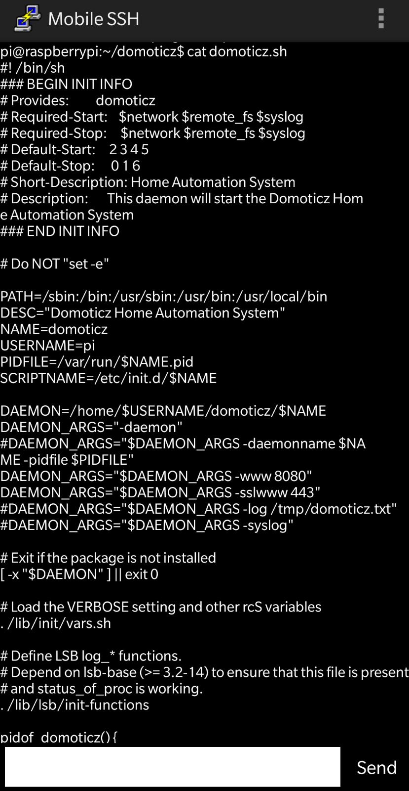

What do you have in the startup config for domoticz?
The config file for domoticz on Raspberry is: /etc/init.d/domoticz.sh
Look for the initial lines containing DAEMON_ARGS=
Jos
Jos

Sorry took some time to find out what to do (noob alert). I did 'cat domoticz.sh'
I see the 443 port. See attachment. What am I doing wrong?
Greets Gijs
Greets Gijs

I think I located the problem; I use a pi hole. The ssl seems to be blocked. Somebody experience with pi hole ivm domoticz 443 port?
Greets Gijs
