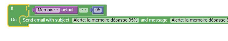

Just discovering event and make a try: send me an email if memory usage is above 95%.
I created the following and it is not possible to save the event (so I guess there is an error in it).
Do you see where is the mistake??
- Domoticz - Google Chrome_2014-04-16_20-05-01.jpg (14.07 KiB) Viewed 2525 times

Re: Blockly basic doesn't work
The issue is the '%" sign in the subject, remove it and try to save it then
Indeed, it works now!
We have to limit to the alphabetical letter in any text?
SweetPants
Don't know, maybe if you 'escape' the character (\%) it wil also work, didn't try that.darrepac wrote:We have to limit to the alphabetical letter in any text?

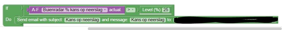

I have configured below working Blocky, the cron job is running every 10 minutes to fetch the actual data from Buienrader.
If the value is above 25% an email is send out, but the notification is send every 10 minutes when the value is still above the 25%.
I want to build some logic into the blocky that prevents this, when the value is below 25% and later at the day it is raised above 25% the notification must send out again.
Someone an idea how to build/ configure this.
Thanks.
Thanks.
