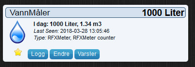

Need some advice on how to tune this script or other settings in Domoticz so I can get the data I want :)
Short on the setup ...
Watermeter with a pulse output ( 1 P pr 10 L )
Fibaro FGBS-001 Universal Binary Sensor, for the input ..
Fresh Ubuntu server install on a ASUS J1800I-C motherboard...
Been running Domoticz on a PI since 2015 before ...
Scrip below are basically the same as posted http://www.domoticz.com/forum/viewtopic ... oor#p22721, was simple enugh for me to understand :D ....
It does work, sort of, but I can't get the numbers I want, as you can see it says 1000L, and not ?? more like 100 or 250 ...
The 1,34m3 are probably correct...
As for the log ... nothing shows up :? just 0L
The divider inside setup are sett at 1 ... I have tried other settings, but then the m3 are way off ...
Probably just a simple typo somwhere, but are not good at scrips :|
Arne Kjetil
--|1.340

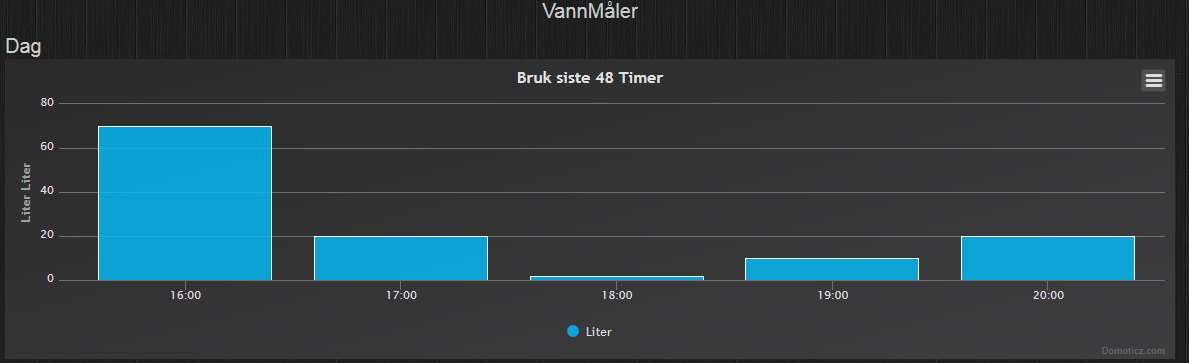

Got it working :)
Just made another costum dummy sensor, an incremental counter, just a counter...
Decided to go for liter, not m3.. made all the math a bit simpler ..
--|120.000
