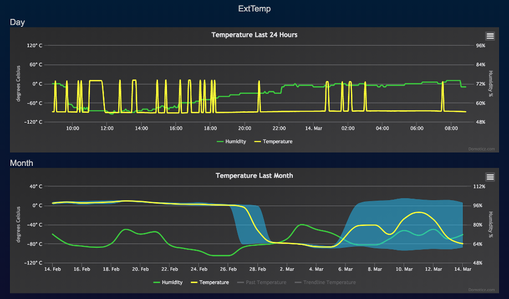

I have a number of these sensors around the house. Recently, a couple of them have started playing up. I've tried changing batteries but it makes no difference.
Sensor one returns more or less random temperatures. Changing the adjustment in the device has no effect. I'm treating that one as failed.
Sensor two is more interesting as it flips between returning true temps and wildly pessimistic temps in the -80s. I've attached a screenshot showing the past day and month
Screenshot
Screenshot
Screenshot 2018-03-14 08.56.06.png (232.31 KiB) Viewed 2348 times
Any idea what might be going on, or is it just another duff device?

Jem101 wrote:The're not a little, squat white thing looking a bit like a flattened egg are they? I have two of them, not much in the way of a identification other than Model : XT200 on the back.
No, these are like small bricks on their ends: 5 x 2 x 1cm
So far, no luck, so back into the bits and pieces box they go....
I’m coming to the same conclusion. The odd thing is that they were fine for a couple of years. Some of them still are OK.

Just an update on this because I've noticed something else odd with these.
I left them connected, but don't use them anymore. They have settled down and have stopped the wild fluctuations. However, I realised just now that their readings are inverted. Thus, one of them says the temp is currently -94C and is dropping. Looking at the curve, it's the inverse of what one would expect: high in the night (-90) and dropping during the day. Very odd.
