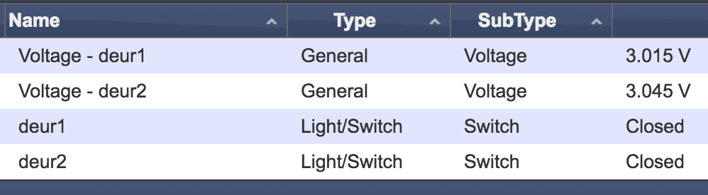

I thought I check my device listings on "deur" and noticed there is also "Voltage - deur1" and "Voltage - deur2" and when there is an update on the voltage the script is triggered. To me this seems to be in error as the trigger is deur* and not *deur*.

But the strange behavior is that if the script only has deur* as device listed it also gets triggered by the two devices that only monitor the voltage of the two door switches e.g.
- Voltage - deur1
- Voltage - deur2
So the script is not only triggered by the two "deur" switches but also through an update of the voltage device.
So these four devices trigger the script due to "deur*" So no door is opened but the script gets triggered by an voltage update from battery of the door switch. For now I will use "deur1" and "deur2" as my triggers and not the simple "deur*"

The script got triggered by the batteries and that is the problem I don't want that. To me a bit awkward as this is not matching with "deur*"
