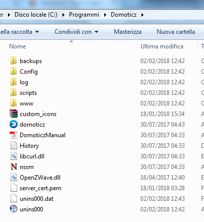

It's possible that I have not plugin folder?
Raspberry PI 3, 3x Yeelight bulbs, 1x Yeeligh led strip, 1x Sonoff with ESP826, Controlicz, Kodi
febalci
Posts: 331
Joined: Monday 03 July 2017 19:58
Re: Python Plugin: MoonPhases
Post by febalci »
corederoma82 wrote: Friday 02 February 2018 12:52 It's possible that I have not plugin folder?
Install 32 bit Python3 first, then create a plugin folder.
corederoma82
Posts: 85
Joined: Saturday 14 January 2017 21:34
Post by corederoma82 »

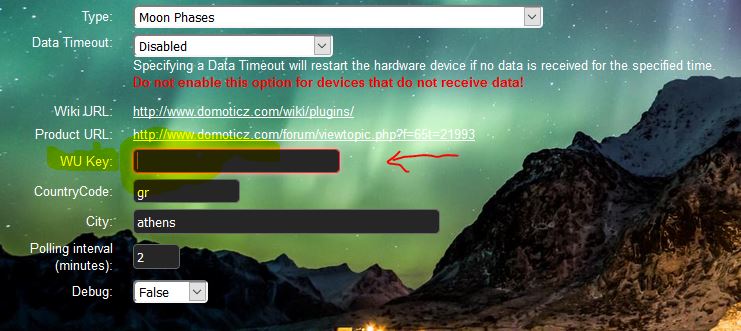

Another question....where I have to put the weather key?
ycahome
Posts: 248
Joined: Sunday 12 February 2017 10:55
Domoticz version: lat Beta
Post by ycahome »
corederoma82 wrote: Monday 05 February 2018 10:01 Another question....where I have to put the weather key?
Here:
