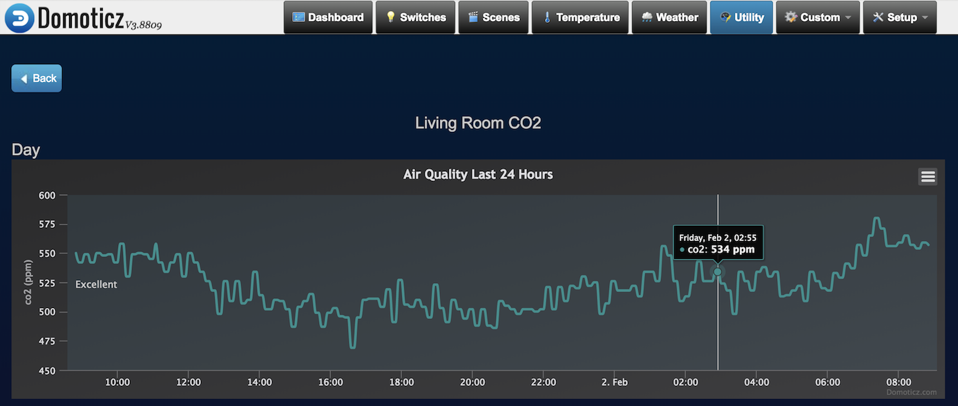

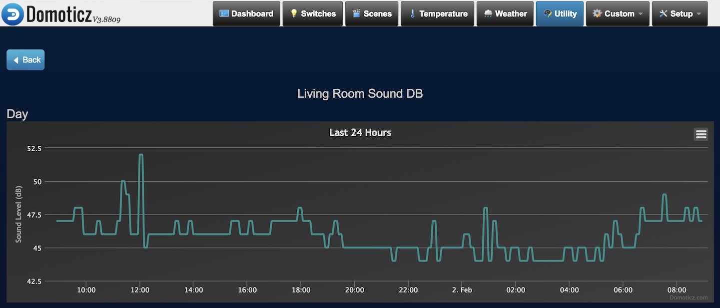

Yes, I only have the Home Coach, it works either with the native Domoticz plugin or via a seperate bash script. It's been running now for about a year and I've been collecting quite a lot of useful data, I like being able to see the average sound level in the room as well as CO2, temperature and humidity.
It's probably my number one most useful sensor. Only thing is I wish it we're possible to get data from it faster than once per 10 minutes but that isn't really a huge problem.
