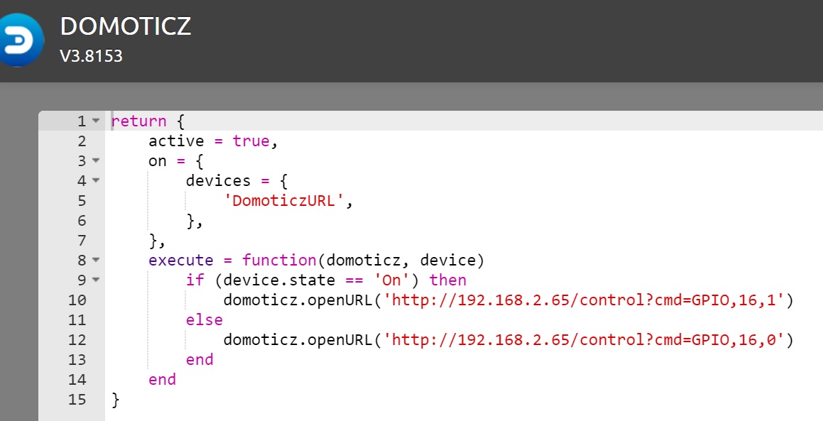

Thanks Danny,
As a test I used a switch command, but the idea is clear:
Life can be easy,
Rob

Yup.. that's it. But in this case I'd do it differently: in Domoticz edit the switch and enter these two http urls as the on and off actions. Then you can do just switchOn() and switchOff() in your code.
