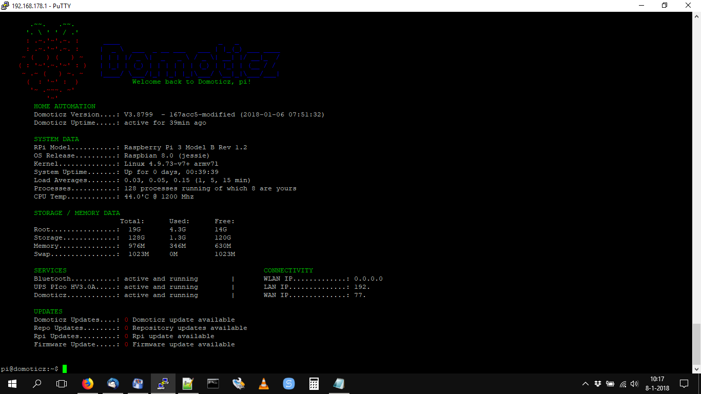

System specs:
Schermafdruk 2018-01-08 10.17.09.png (64.33 KiB) Viewed 522 times
