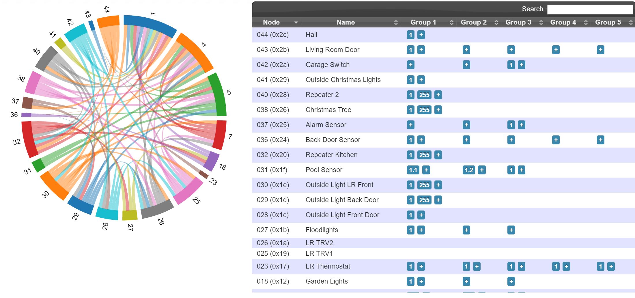

Below is my current setup, where I've got some devices that have good mesh, but keep 'bouncing' on after they've turned off...

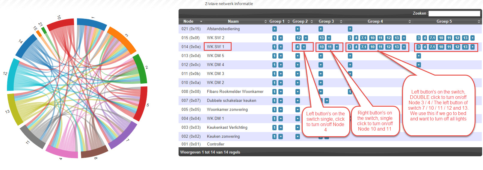

I'm using the groups in combination with my fibaro switches and remote wall switch (ZME_WALLC-S).
I have configured the remote wall switch to turn on some of the lights in my living room and if I double click on the switch all lights in the living room and kitchen switch off.
See attached picture with explaination how it works in my situation.
Group overview
Group overview
Hope this helps.
